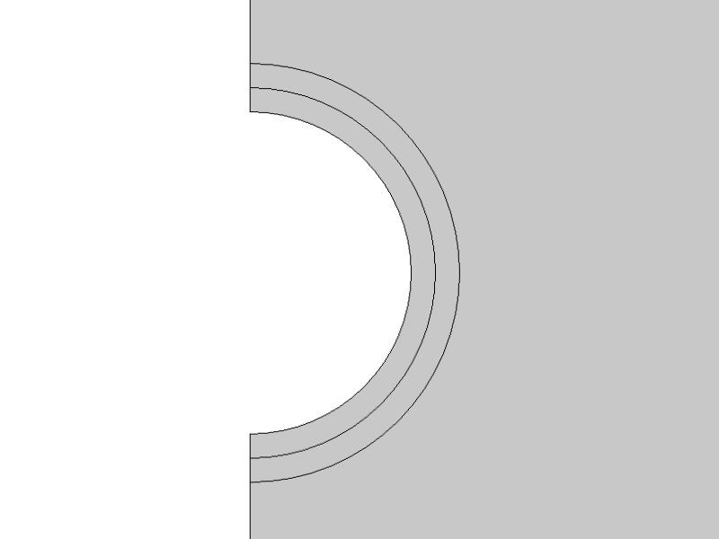

Thank you for the suggestion sir,
But, See the image attached.
I have tried what you have suggested.
Here I A have 2 concentric spheres (say s1 and s2 starting from the inner most one) over which a fluid is flowing . I have applied your suggestion of 2 diffusion coefficients in the 2 domains and on the outermost surface I have used a flux condition as fluid is flowing over.
my doubt is what condition should I specify at the inner most boundary of s1? 'No flux' condition is not working in my case. There my concentration is a function of time. I have searched a lot but I didn't get any appropriate analytical expression for time dependent concentration.
Can you provide any help in this case?
Thank you for the suggestion sir, But, See the image attached. I have tried what you have suggested. Here I A have 2 concentric spheres (say s1 and s2 starting from the inner most one) over which a fluid is flowing . I have applied your suggestion of 2 diffusion coefficients in the 2 domains and on the outermost surface I have used a flux condition as fluid is flowing over. my doubt is what condition should I specify at the inner most boundary of s1? 'No flux' condition is not working in my case. There my concentration is a function of time. I have searched a lot but I didn't get any appropriate analytical expression for time dependent concentration. Can you provide any help in this case?

I thought that the inner sphere is the source of the diffusing species, but in your image that is an empty cavity, i.e. it is not a part of the simulation domain?
If you need a time dependent concentration at the inner boundary, define an appropriate function under
Component --> Definitions --> Functions
Let's assume that you have defined a piecewise function that is named "pw1". Then, at the boundary call it as pw1(t).

Thanks for the suggestion sir.
Sir,
In my model the thickness of the 2 layers decreases with time because of diffusion. So I have used the deformed geometry physics for this purpose.
In my inner layer the concentration is constant and becomes zero only when the thickness of this layer becomes zero.
When I am running the simulation with deformed geometry. It was displaying an error, 'Inverted mesh element'
Do you have any suggestion about how can I over come this?
Thanks for the suggestion sir. Sir, In my model the thickness of the 2 layers decreases with time because of diffusion. So I have used the deformed geometry physics for this purpose. In my inner layer the concentration is constant and becomes zero only when the thickness of this layer becomes zero. When I am running the simulation with deformed geometry. It was displaying an error, 'Inverted mesh element' Do you have any suggestion about how can I over come this?

When the thickness approaches zero, there won't be anything to be meshed. I have no clear solution to this, but if you define the thickness by a parameter, also the mesh can be parametrised. Like:
d = thickness of the layer
N = d*10 = number of layers in a mapped mesh
What kind of meshing are you using?
When the thickness approaches zero, there won't be anything to be meshed. I have no clear solution to this, but if you define the thickness by a parameter, also the mesh can be parametrised. Like: d = thickness of the layer N = d*10 = number of layers in a mapped mesh What kind of meshing are you using?
I am using free triangular mesh.
Thanks for the suggestion sir. I am using free triangular mesh.
