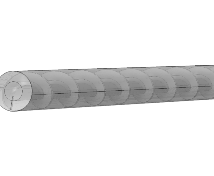

I am trying to mesh helix geometry since last 1 month, but everyday i encounter new errors. So, till date i have seen 15-20 type of meshing errors.
I tried different meshing techniques but all the techniques have without fail generated error.
Can anyone plz help me in chalking out a method or sequence or manner by which i can mesh this helix.
The file size is big so if anyone wants to have a look plz mail me(cdesai@mtu.edu) or post on this thread.
I am attaching image of it for primary reference.

You can considerably reduce the file of the .mph file by clearing all solutions (Using the button for that on the Mesh ribbon) and clearing all meshes (Using the button for that on the Study ribbon).

Have you read through these blog posts? They might help.
www.comsol.com/blogs/improving-your-meshing-with-swept-meshes/
www.comsol.com/blogs/improving-your-meshing-with-partitioning/
