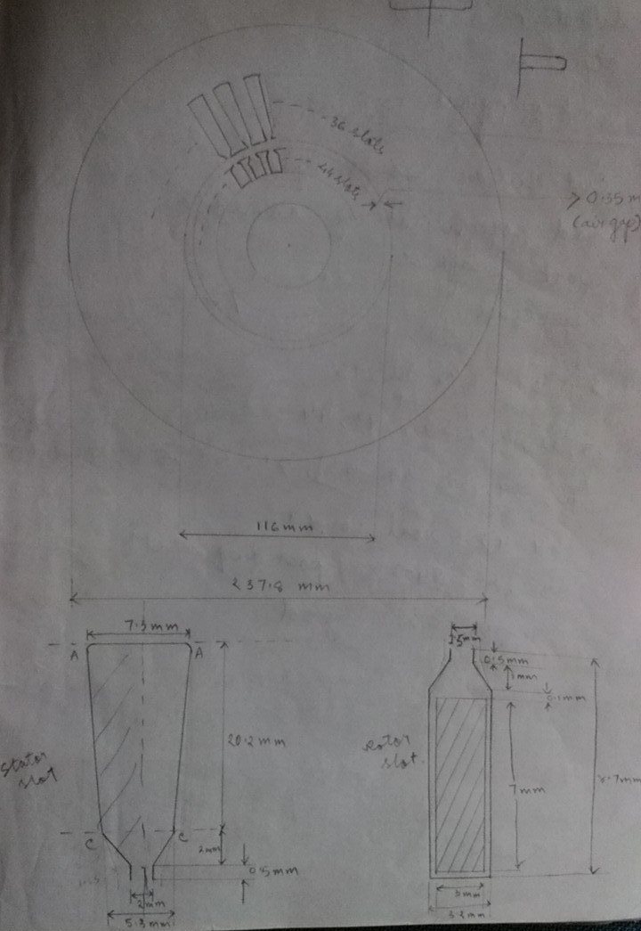

drawing the cross section of an induction motor
hello... i want to draw the cross section of the induction motor with all the slots in stator and rotor. i have attached an image of the structure. please help me drawing this. i am not being able to do it in my comsol multiphysics 4.4 version. is it possible to draw it in some other software and import it? its been told but i am not being able to import diagrams from catia and creo.

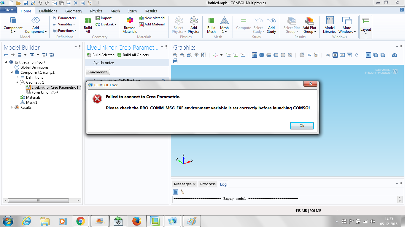

I tried the livelink option for creo parametric 2.0. but when I tried to synchronise an error message appeared.
Failed to connect to Creo Parametric.
Please check the PRO_COMM_MSG_EXE environment variable is set correctly before launching COMSOL.
I have also attached the screenshot. please help me in importong file to comsol from creo parametric.
I tried the livelink option for creo parametric 2.0. but when I tried to synchronise an error message appeared. Failed to connect to Creo Parametric. Please check the PRO_COMM_MSG_EXE environment variable is set correctly before launching COMSOL. I have also attached the screenshot. please help me in importong file to comsol from creo parametric.
