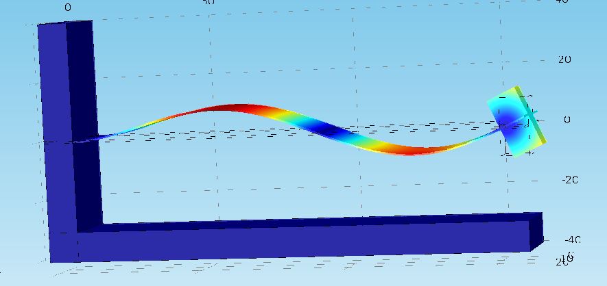

Hi, I'm trying to model a cantilever beam base excitation, one end of the beam is fixed on the base, with the excitation of 0.5g and 5Hz, there is a nonlinear magnetic force applied on the tip mass which is simplified as third order polynomial ay^3+cy. y represents the displacement. My question is how to applied this nonlinear force, and which study I should use, eigenfrequency, frequency domain or time dependent? Thank you very much.
