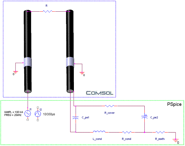

Posted: 2 decades ago 29.09.2010, 05:37 GMT-4
Thanks for your quick answer. I will try in some way to simplify the model or make partly calculations.. By the way i attached the picture of the task. The model I put in the air. Maby you could see more because I didnt see how I can use symmetry. The task is research electric strentgh between the cables. The critical point (of max value of the electric field) must be near of the point combination of air, earth fastener and covering. I couldnt make smaller the cable length because there is effect of equalised electrical field at the surface of cover. Thanks a lot.
