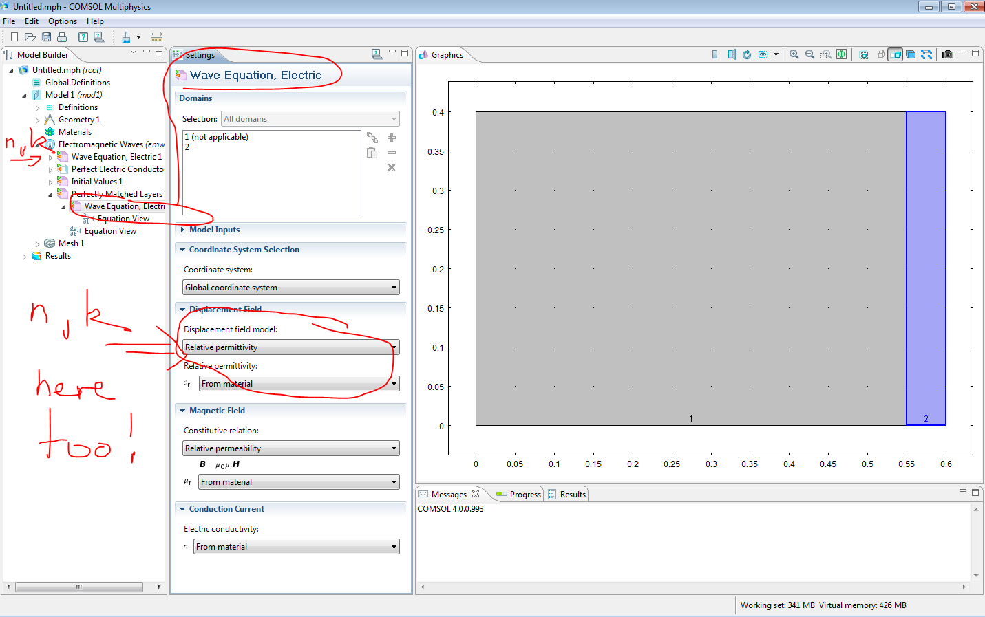

have you checked the material data sub-node ? when you add a PML yu must also redefine the material data use, by default it's in epsilon_r mu_r and not n,k, even if the main physicshas been redefined to n,k.
This is just one possibility, might not be the issue ;)
Hi have you checked the material data sub-node ? when you add a PML yu must also redefine the material data use, by default it's in epsilon_r mu_r and not n,k, even if the main physicshas been redefined to n,k. This is just one possibility, might not be the issue ;) -- Good luck Ivar

yes I expected that, but there is one in the PML definition sub-node too and both/all must probably be set to n,k and not left to their default eps_r mu_r. I have been fooled a few times already on that one ;)
hi yes I expected that, but there is one in the PML definition sub-node too and both/all must probably be set to n,k and not left to their default eps_r mu_r. I have been fooled a few times already on that one ;) -- Good luck Ivar

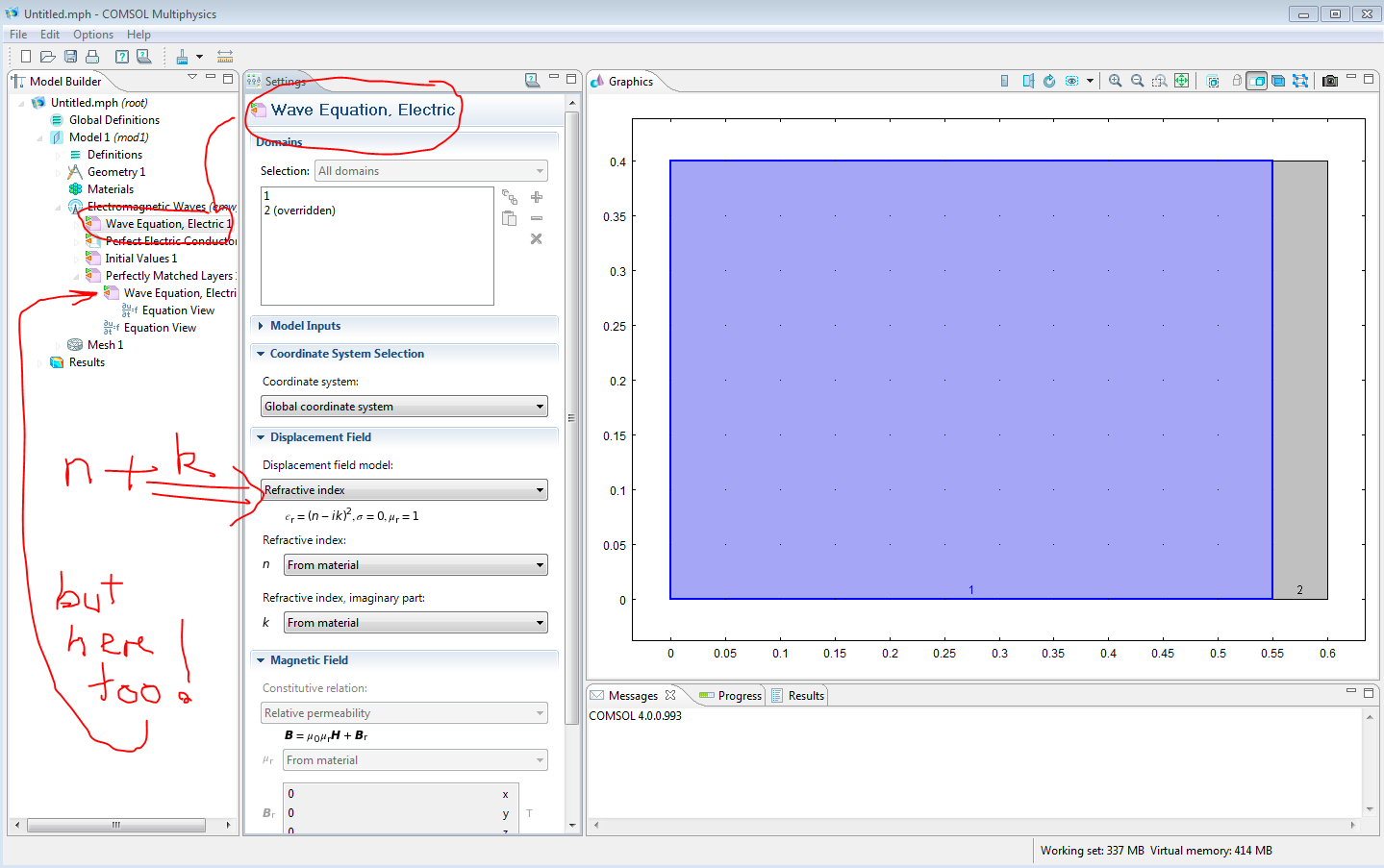

As I said above, but I did not expalin it well enough, n,k must be set in TWO different places for RF, in the main "Wave equation" setting (capture.png) AND in the Wave Equation sub-node of the PML node (capture1.png)
This is easily forgotten, but if you have set both correctly, then you have another isue, that I do not understand ;)
Hi As I said above, but I did not expalin it well enough, n,k must be set in TWO different places for RF, in the main "Wave equation" setting (capture.png) AND in the Wave Equation sub-node of the PML node (capture1.png) This is easily forgotten, but if you have set both correctly, then you have another isue, that I do not understand ;) -- Good luck Ivar
