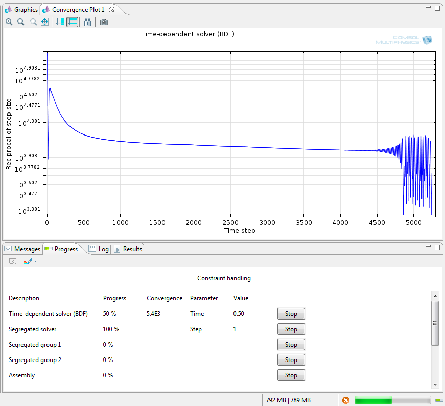

Just want to know, what does that curvy distorted line at the end of the diagram shows?
Does it mean I have instability convergence? too large time step?
how do I solve this? I am getting singularity error everytime.

Even I am facing facing the same issue with Time dependent optimization.
However, reducing the time step, doesnt going really affect the error, but you get the error after a prolonged time. (I got it like that), however for many it worked by reducing the time step.
Whatever the timestep you give in the solver, its just for post processing and it has nothing to do with the calculation (I hope so), as the comsol has inbuilt time stepping which will calculate at those time steps.

I solved the error already,
I did it by reducing the time step in my "Study: Time-dependent" for example by making range (0,0.5,1) to range (0,0.1,1).
And I also followed the "improving convergence in nonlinear time dependent model" on the COMSOL discussion. (www.comsol.com/support/knowledgebase/1127/)
Do you know what it means by convergence? What does it value shows actually from the image that I have attached? What does it mean if the convergence decreases or increases as time goes on?

There is already an discussion on convergence in the forum,
here you go for the link,
www.comsol.com/community/forums/general/thread/35375/
Hope it helps.
