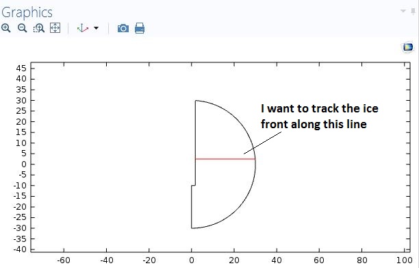

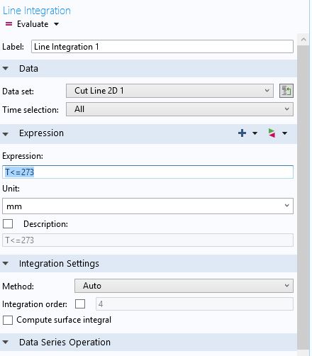

Hi, I am modeling a freezing problem and would like to track the position of ice front (defined by T=273K). I applied a line integral at a defined 2D cut-line on my domain and under the expression in line integral, I assign T<=273K. I managed to plot out the ice-front but by comparison with manual probing on the temperature contour, the position of freezing front at a certain time is different. Is my method of tracking an isotherm correct? If not is there any other way of doing it? Thanks!
