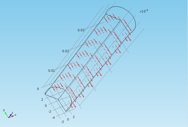

                                                    I'm trying to model flow inside a rotating pipe.
I think I have managed to set up the model correctly, the results in most plots look intuitively correct.
However, when I try the arrow volume plot for the fluid velocity, I get a situation where although the arrows are in the right location and have the right magnitude, they are not pointing in the direction of the local fluid velocity vector. Rather they all end up pointing along the (negative) y-axis.
I assume I am missing a link or checkbox somewhere, but I don't know where.
What am I doing wrong?
