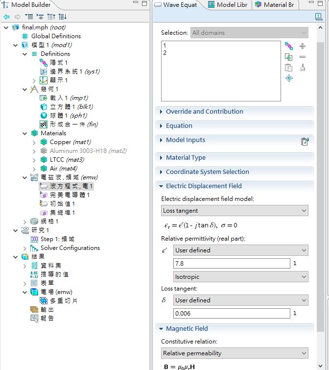

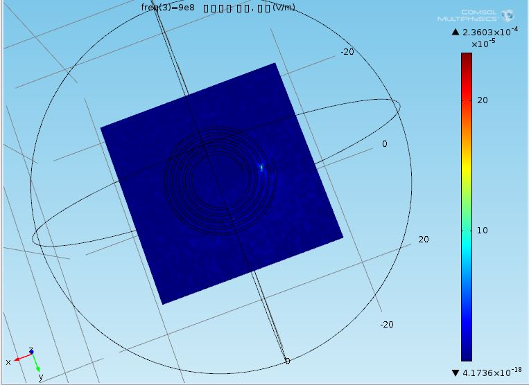

I want to simulate the antenna electric field intensity.
but the result is too small and strange.
I need to try the impedance boundary or some other ?
the file is too large so I add some picture.

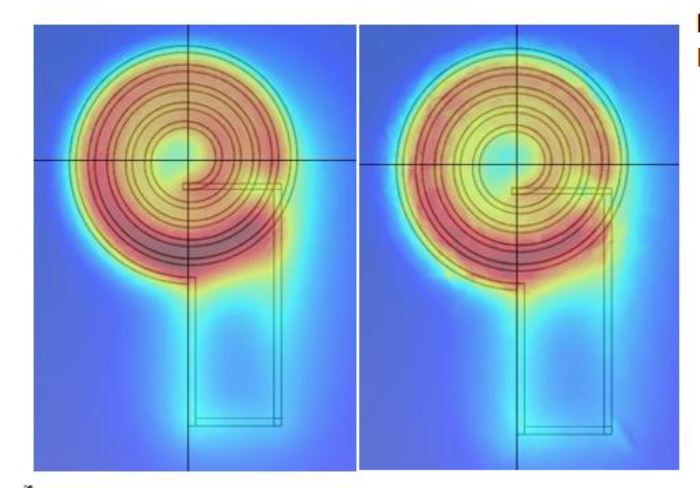

the fig.c is my expect .

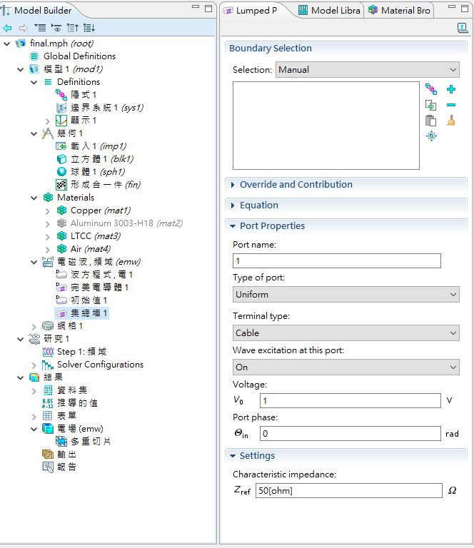

it seems you haven't assigned a boundary in the port node.

Hi, it seems you haven't assigned a boundary in the port node. Cheers Edgar -- Edgar J. Kaiser emPhys Physical Technology http://www.emphys.com
