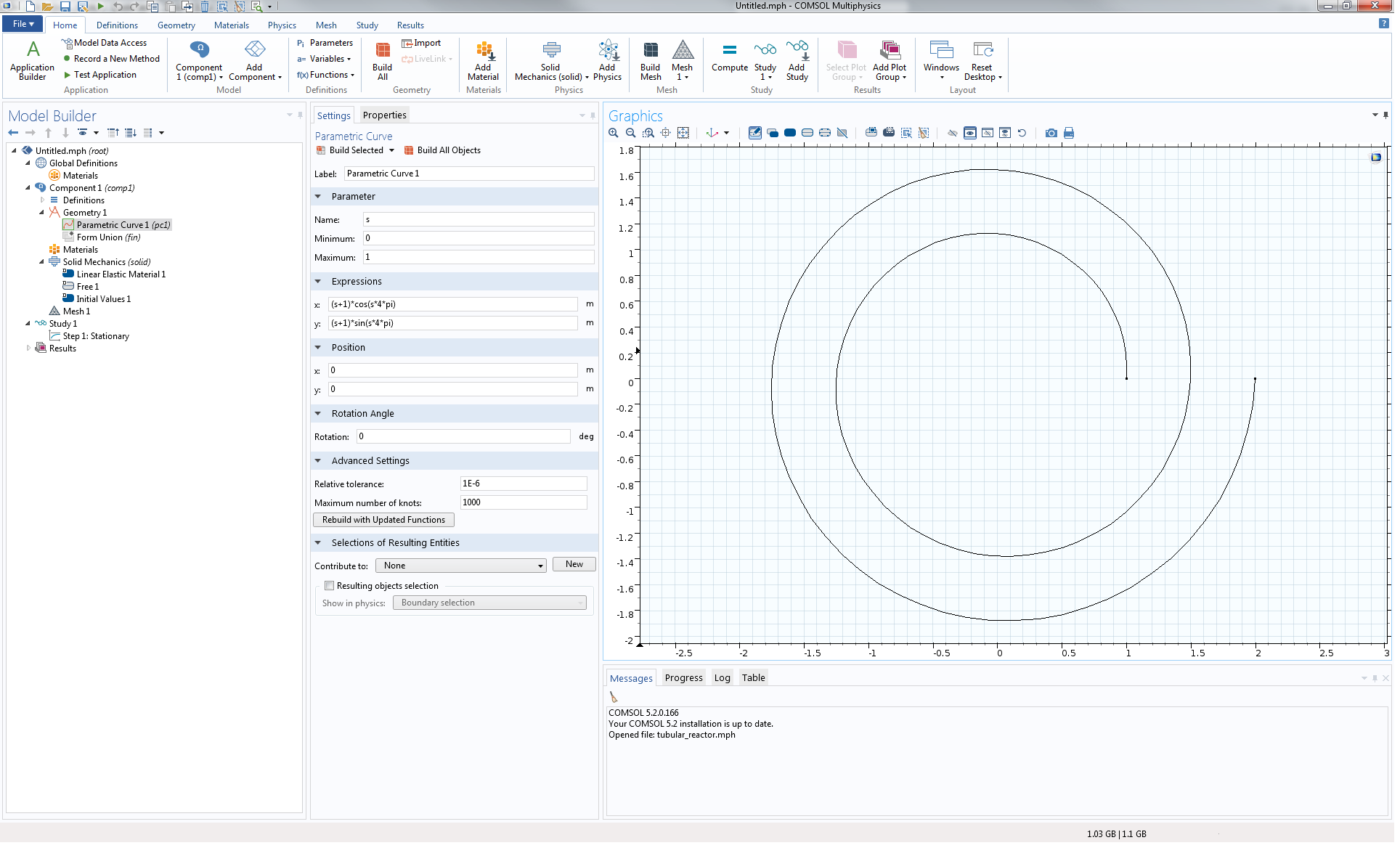

Hello Vasantharajan,
You can use a parametric curve, like in the attached screenshot, to specify a spiral.
Hello Vasantharajan, You can use a parametric curve, like in the attached screenshot, to specify a spiral. Best, Jeff

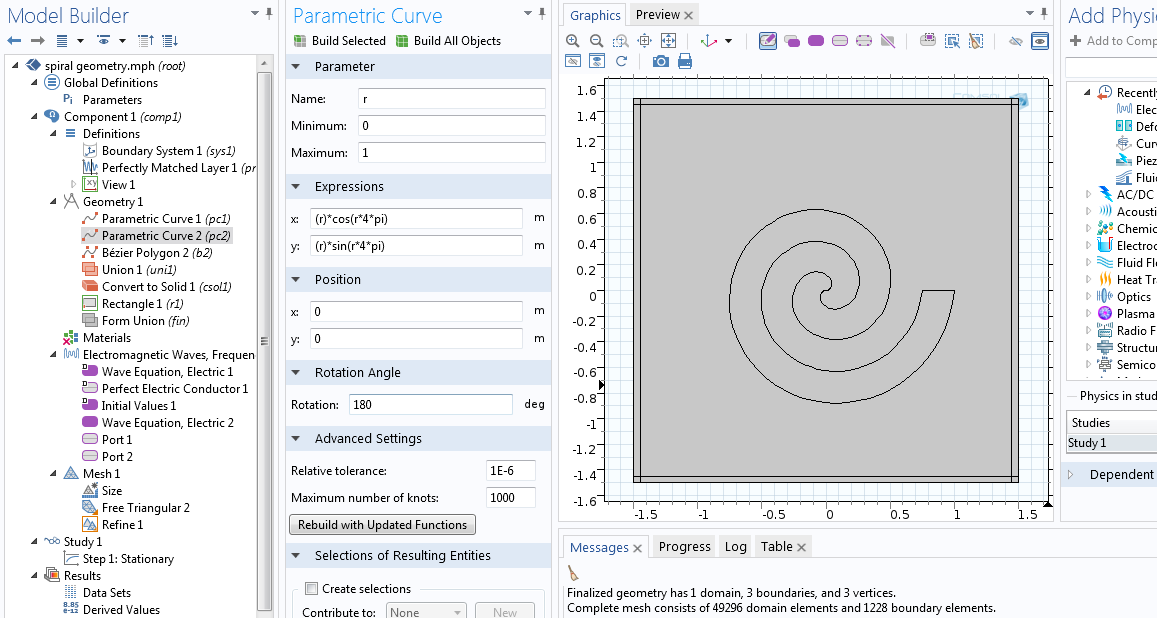

Posted: 10 years ago 12.01.2016, 10:03 MEZ
Hello Jeff Hiller,
I tried with two parameters and got a structure as like in the image after the union and converting to solid. Now, I wish to adjust the thickness of the solid. But, to do so, I've to change the parametric curves, union them and then convert to solid, each and every time. Instead, is there any option to define parameter for the new solid? So that, we can directly vary the parameter of the solid.
Hello Jeff Hiller, I tried with two parameters and got a structure as like in the image after the union and converting to solid. Now, I wish to adjust the thickness of the solid. But, to do so, I've to change the parametric curves, union them and then convert to solid, each and every time. Instead, is there any option to define parameter for the new solid? So that, we can directly vary the parameter of the solid.
