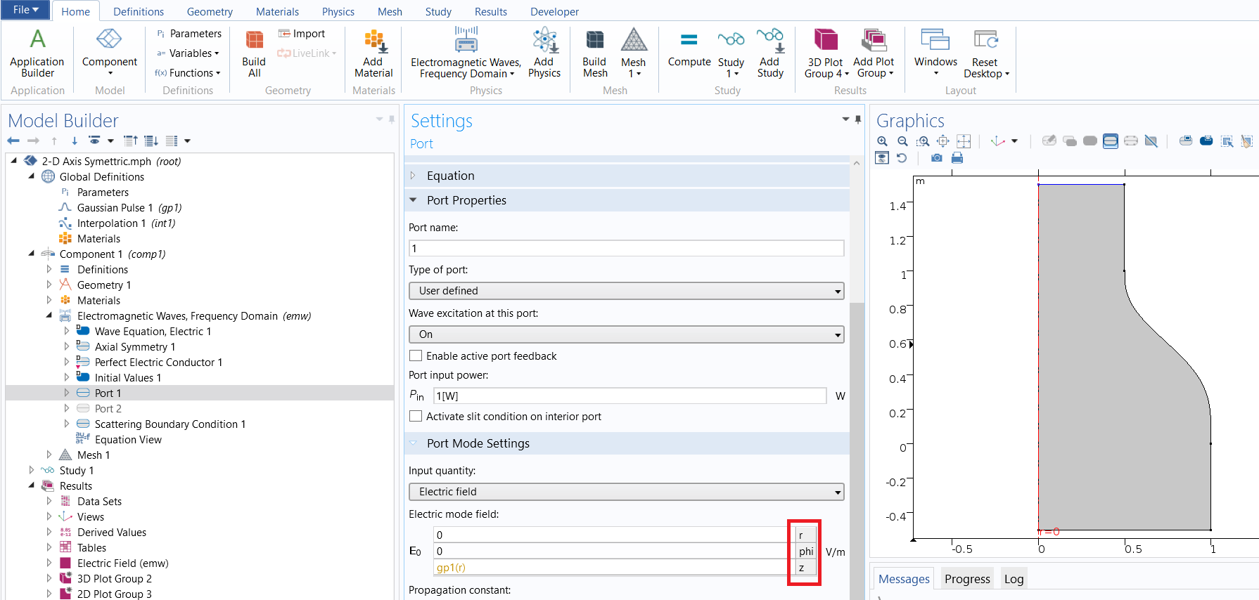

I was using the 2-D axisymmetric electromagnetic module to simulate a 3-D case. I can see that all fields are defined as Er, Ephi, Ez in this axisymmetric case in both "port" and "electric field". I want to define a wave with y polarization or x polarization. How can I do that? Also, clearly I can not express my desired x or y polarization base on R and Phi components since it involves sin(phi) and cos(phi) which are not recognizable by this module.

First of all, it sounds to me like you might be better off using a different representation (such as 3D). The 2-D axisymmetric model presupposes that your problem has 2-D axisymmetry; a plane wave does not directly exhibit that symmetry. That said, there can be extensions employed that, in some cases, will still allow you to do limited work in the 2-D axi-sym mode while using field distributions that do not exhibit that symmetry! But you will have to be very careful to do the math properly. For a very good example of how this can be accomplished, see the "conical horn lens antennna" in the Comsol-supplied application library, for the RF module.
