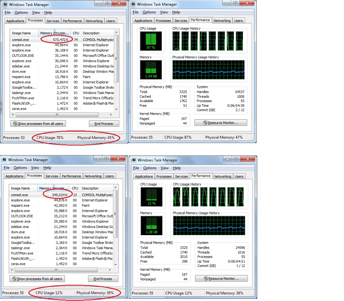

The CPU and RAM usage oscillates a lot. CPU varies from 14% to 95% within every few seconds. I've attached a few screenshots.
I think its sensible that the Physical Memory never crosses 1.5 GB because only 2GB is allowed per process on 32-bit (of my total 4 GB) ?
But the Memory in the Task Manager processes page (Private Working Set), never crosses 0.5 GB.
Harish

Posted: 2 decades ago 16.10.2010, 10:40 GMT-4
first of all try the task/process manager of www.sysinternals.com (you should be redirected to Microsoft as they have bought out the guy and all his good stuff ).
2nd note that the solvers are oscilalting between different operations and not all can be parallelised, this results often in oscillations between 1 processor active and all processor active, at a frequency depending on the size of the model
3rd not all solvers can use several processors for their task
4th, since a MS update a couple of months ago, I have noticed that it looks like MS is not allowing all processors to go full speed over long periods, at least something has changed since this summer on my VISTA's memory management, but I did not record my screen views so it's hard to compare fully
