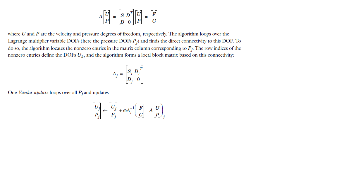

Matrix has zero on diagonal for the SSOR update submatrix in the Vanka algorithm.
In the Comsol reference manual, explanation for matrix equation for vanka algorithm is attached in the picture
Is the diagonal element (Sj) = 0? This S corresponds to the average values of the velocity vectors?

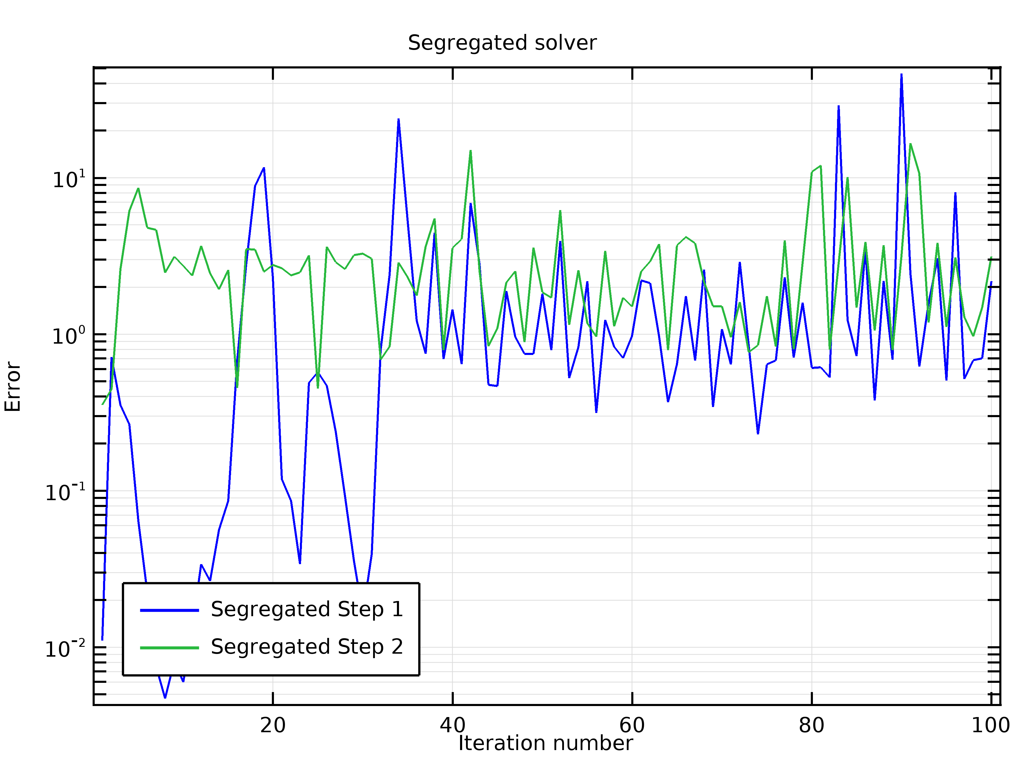

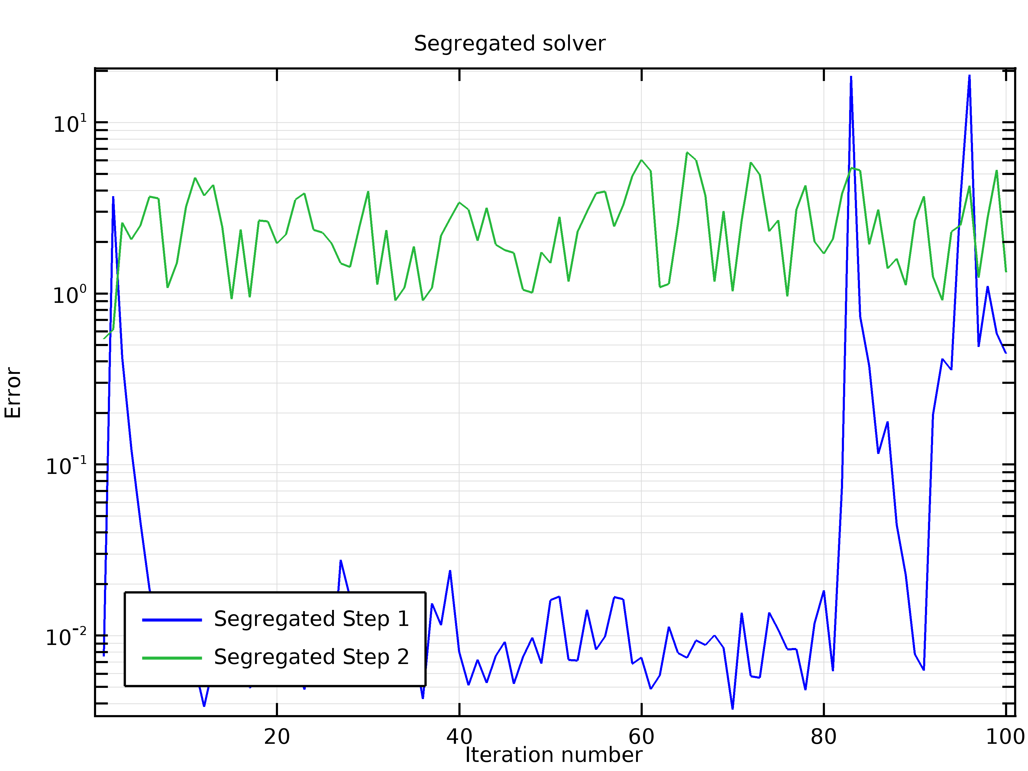

For direct solver with a fine mesh i get the error message with a convergence plot for the segregated solver attached in the picture:

for the default solver settings with a finer mesh i get the same error message with a convergence plot for the segregated solver attached in the picture:
Failed to find a solution for the initial parameter.
Maximum number of segregated iterations reached.
What to diagnose from this?

The problem you are solving is very common test problem in academic communities for CFD. My guess is perhaps you are doing this for part of your education. So, I do not need to do this for you. You need to learn how to do this for yourself.
My only advice is that you need to first make the problem very easy to solve, with the least level of the driver that is forcing the problem. For the cavity problems, it is usually the temperature difference between the walls. Make that small, make the mesh very coarse. Get a solution to converge for the simplest form of your problem first. Then start increasing the forcing term, refining the mesh, making the problem tougher to solve.
This is how you need to learn to solve most any problem numerically. This is basic stuff.
