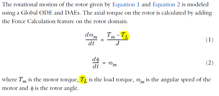

Im got my LSPMSM motor working fine but i wanna add a load torque to my motor and i really don't have idea how to add it. Im using 2d model with rotating machinery magnetic. I read some thread about it but i can't find answer for my question.

You can add the rotor dynamics equations using a Global ODEs and DAEs interface. In the same equation, you could include the Load Torque as shown in the attached image, where T_L is the load torque and Tm is the electromagnetic torque. Usually Tm is calculated from the Rotating Machinery, Magnetic interface.
Hope this helps.

Nirmal thanks for your help i will try add the equation to my project.
