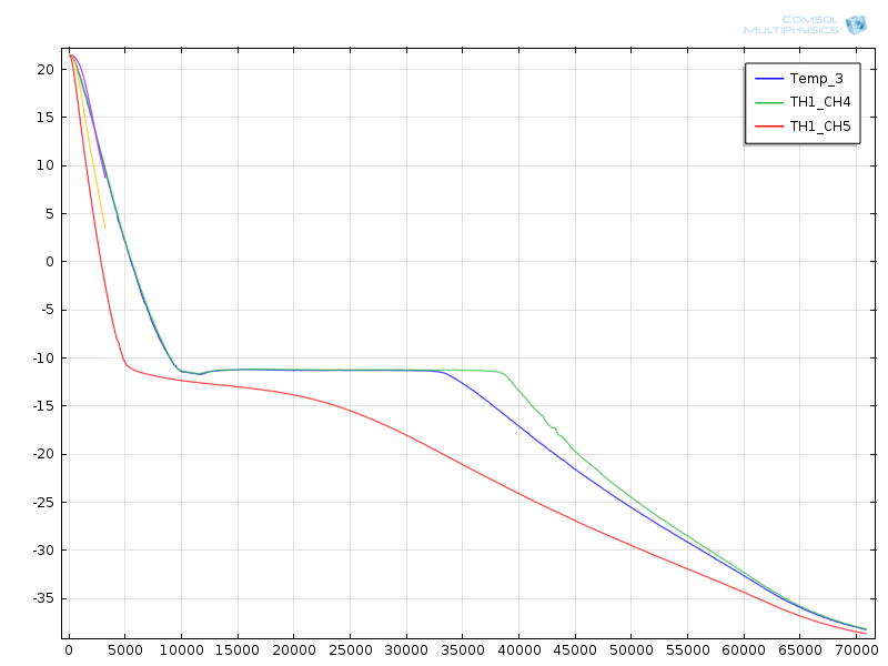

i use Comsol V4.2a, In Results there is Tables, i would like to insert new Table, and then i want to import my Data into this Table, but i don't know what kind of Format?
Do you have ideas?

Thanks for your answer.My idea ist that when you have a table of experiment (i.e *.xls, *.dat,*.txt...), you can import into the Result, then when you run your Modell, you can compare your result of Simulation with the Data of experiment. you can see in the attach file, the yellow and pink line are result of Simulation and the different lines are result of experiment. The format of this file can be *.txt or *.csv.

If you import your experimental results into a piecewise or interpolation function, then you can define a material property variable as a ODE dependent variable and solve in a mean square way to adapt a particular variable or property to your experimental data.
