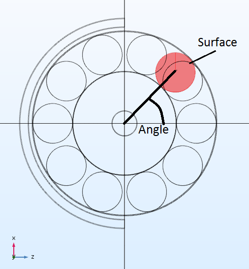

I am running a stationary magnetic simulation. I have a 3D surface (a disc) over which I am integrating the normal magnetic flux density to get the total magnetic flux through the surface.
With much pain, I created the surface using the "Parameterized Surface" feature. I computed the flux using "Surface Integration," a "Derived Value." The result that I see in the table when I click "Evaluate" seems reasonable.
I would like to achieve two things, and I'm hoping someone can point me in the right direction:
1) I am not only interested in the flux at one point; I need the flux at many points as I vary the (radial) position of the surface. Because I am interested in surface positions along a circle, only a single parameter (angle) need be swept for the surface position. I was hoping that there was some sort of "Postprocessing Parametric Sweep" option, but I don't see one. Being that position of the surface does not alter the solution, re-solving the system for each radial position of the surface (which is what happens if I use the regular "Parametric Sweep" tool) seems unnecessary; this should be limited to postprocessing only. Any advice on how I can compute angle vs flux in this way? See attached image.
2) I would then like to plot / export a table of the values of interest; that is, radial position (the swept parameter) vs total magnetic flux (the derived value). I realize that I can't even plot what I do have (can you not plot a derived value?) so I figured I would ask this question along with my first. How would I plot / export the output of the sweep described above?
Thank you for the help,
Rob
