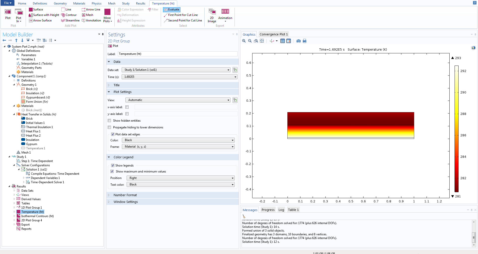

Hello helpers,
Currently i working on a simulations of a wall section.
In this case its simplified and only existing of a brick outside wall, insulation layer and gypsum on the inside.
In order to full my needs, i would like to vary the thickness of the insulation layer (in between the other layer) to see what exactly happens regarding temperatures on certain locations and the heat fluxes.
How can i set this up in Comsol 5.2a?
For info; currently im also using an interpolation for the outside temperature
With kind regards,
Glenn

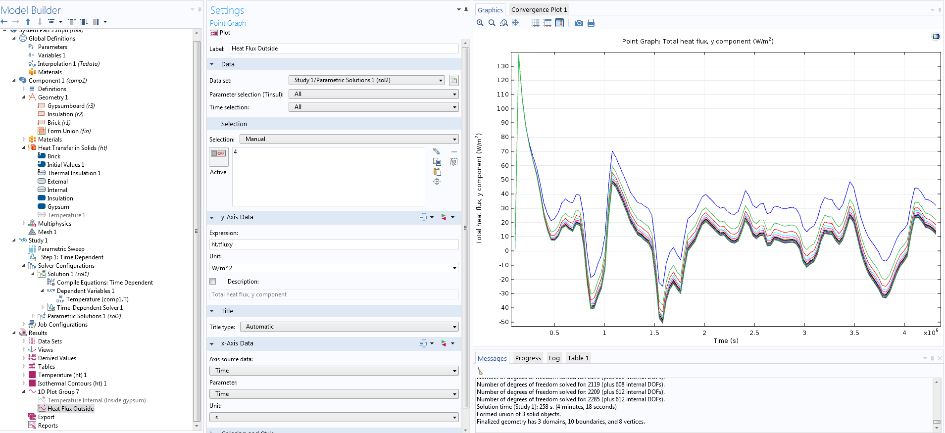

Thank you very much Ivar
I managed to do it.
However, i end up with a follow up question.
Added, i computed the outgoing heat flux during the year for different Tinsul (insulation thickness).
Now i would like to calculate the surface under the graph (so the total heat flux in the year) and set the up against the Tinsul. So on the y-axis the total heat flux in the year and x-axis the Tinsul. For the total heat flux only the positive numbers some be taken into account (i need to neglect the inward heat flux what occurs when the outside temperature is higher then the inside temperature). How can i set this up easliy?
Thanks on beforehand
Thank you very much Ivar I managed to do it. However, i end up with a follow up question. Added, i computed the outgoing heat flux during the year for different Tinsul (insulation thickness). Now i would like to calculate the surface under the graph (so the total heat flux in the year) and set the up against the Tinsul. So on the y-axis the total heat flux in the year and x-axis the Tinsul. For the total heat flux only the positive numbers some be taken into account (i need to neglect the inward heat flux what occurs when the outside temperature is higher then the inside temperature). How can i set this up easliy? Thanks on beforehand
