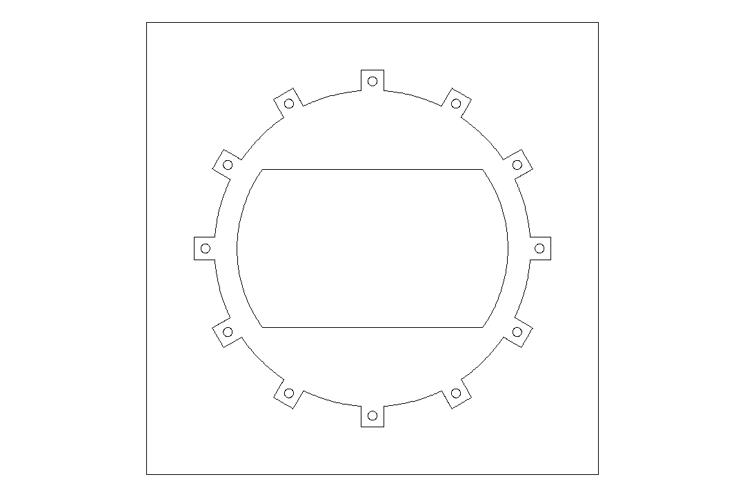

Dear Comsol Users,
I am trying to model a simple rotating machine in Comsol 4.0a. I am attaching the model file.
Unfortunately, I couldn’t find any documentation or examples how to start up a model using the “Rotating Machinery, Magnetic (rmm)” physics interface, where a time dependent solution is done. Do you have any similar models available as an example for me?
It is hard to formulate my questions, as I basically cannot get the model to work properly. For example, the field lines I get in the airgap don’t seem to be continuous.
I tried opening the 2D generator example for v3.5 in v4.0 and tried to trace the steps back but it didn’t help as in v4 it didn’t make use of the physics interface I wanted.
I would be very happy if you could take a look in my (very simple) model and tell me
- how to define that rotating permanent magnet properly,
- how to model the rotation, moving mesh, airgap (continuity) boundary conditions
- how to post process in order to see the field lines for different time steps
I am sorry for formulating this in such a poor way, but I tried many different things and got confused over the settings, and I thought instead of going through what I did step by step, I should just ask for the better way of doing it on this really simple model. I hope someone could help me.

not all the features used for rotary machines were ironed out in 4.0, you should upgrade to the latest version, it would run far smoother and better !

Thanks for the answer. I took the advise and tried it in v4.1.
I opened the model example of rotating generator (2D) for v3.5 in v4.1 and changed the physics a bit.
If you open the attached file, in the post processing window it is clear that there is something wrong, as the non-moving part is not updated as I try to look at the solutions of different time steps. I tried with the different x,y,z, or X,Y,Z frames but couldn't find the right-looking combination. Furthermore, the axial torque and the z-torque are not the same, which I wasn't expecting. Therefore I am not sure if I am having a post processing problem or if the model itself is wrong.
I would be very happy if you could take a look into the model. Thanks in advance!

you are right that the model library example is a 3D withou any rotation part.
But for me your model seems OK (apart that there is no current in the coils=air so OK you are probably in generator mode, but more important: you are in geoemtry "union" mode so the rotating part is "fixed"
you must group (composed geometry but that is already done) all but the central ring and then use "assembly" mode + add a continuity/identity pair for boundaries
{32, 33, 63, 64} with {121, 122, 138, 139]
+ add the "continuity pair" in the physics
you should also use L=0.4[m forthe physics length (Z direction) I believe or you have foreseen to calculate per 1[m] and normalise with L ?
and your internal variables should use "rmm.Ez" and not the 3.5a name emqa.Ez
finally use a finer time step to better resolve the oscillations with 1 turn/sec and 8 poles you have 4 sinus per turn
With that I see a 4V amplitude sinus out
