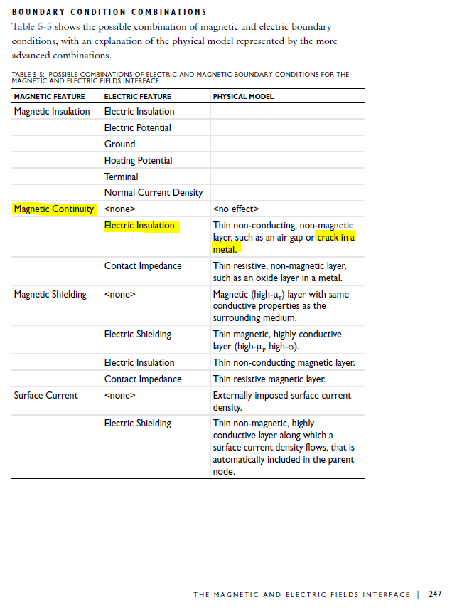

The small cracks in the metal structures can be modeled in Magnetic and Electric Fields (MEF) physics using the combination of "Magnetic Continuity" plus "Electric Insulation". Unfortunately, this is not available in the Magnetic Fields physics.
Hope this helps.

Thanks. Gave it a try and got comparable results a bit faster. I'll explore this a bit more
