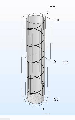

I'm a new user in comsol and now I have a problem. If you explain me this moment I will be very gratefull for you. I'm trying to calculate a helix edge tension after loading. It's the simplest model. It's a cylinder with interrior helix. After loading helix will be streched. I need to know what his length will be. I've displayed a line graph (total displacement), but It isn't what I need. What I should choose in a gap expression for showing edge length?

Yi Luo, Thank you for your reply. Indeed I have ploted the graph expression/arc-length. But It was the line with length before calculation and expression showed the expressions meaning in each point along the line. For example, If I plot displacemen(arc-length) in line graph window, I will get the extended curve line, but I still need only one meaning for the line - length. If I integrate all line segments of this curve, I will deduce the arc-length aftec calculating. Is's possible, but It's more difficult (I should calculating, export data, import data to matlab...) than getting necessary result in Comsol window. I've believed that It's possible to show the true arc-length in default comcol window.
Edgar J. Kaiser and Henrik Sönnerlind, thank you. It's right way which I've been finding. For showing arc-length I should add the coupling function - integrated fuction. I sould choose the edge or the edges. After meshing I should write in Y-expression gap name of integration fuction of value "1". And after all actions if I plot the line graph It will show only one point value - arc-length.
