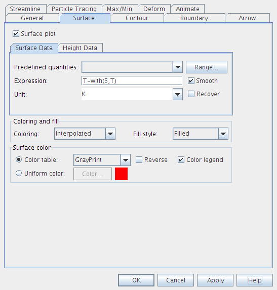

Thank you Jean-Francois, I used the following in the Plot Parameters dialogue box, 'Surface' tab, Expression field:
T-with(5,T)
and got something like what I was expecting.
I must say, i find the COMSOL help extensive, but almost inscrutable. To track down the possibility of using the with() operator inside this expression field you must wade through many cryptic explanations (cryptic to me anyway at the beginner level).
Ho ho! Great! Thank you Jean-Francois, I used the following in the Plot Parameters dialogue box, 'Surface' tab, Expression field: T-with(5,T) and got something like what I was expecting. I must say, i find the COMSOL help extensive, but almost inscrutable. To track down the possibility of using the with() operator inside this expression field you must wade through many cryptic explanations (cryptic to me anyway at the beginner level).
