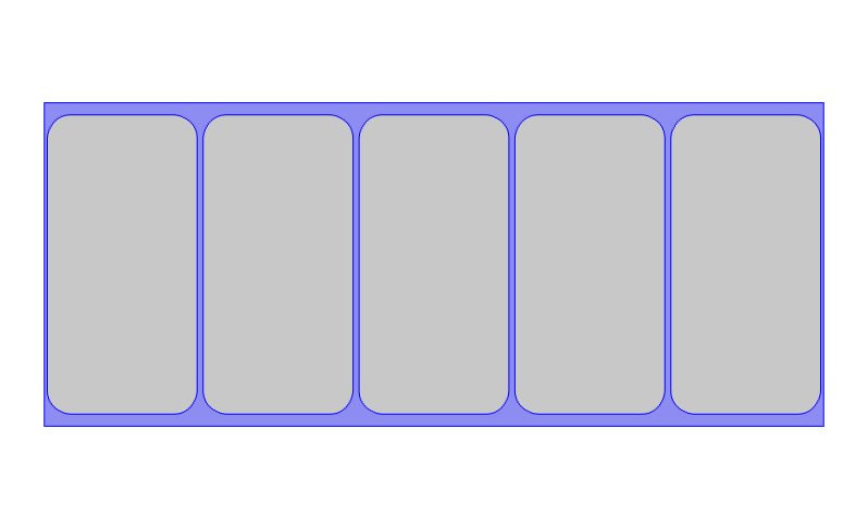

Hi, I was trying to compute the profile of molecule concentration (which is the result of certain stationary or time-dependent study) by projecting the 2D data onto a 1D axis. Like showing in the attached graph, molecules can only diffuse in the blue region and I want to look at it concentration profile in the horizontal direction (x-direction) by averaging its concentration in the vertical direction at every x location. I understand this can be done by exporting all of the data and using MATLAB to do the averaging part. But the exported data files are huge for the real geometry I am looking at. I wonder if this can be done within COMSOL? Thank you!
