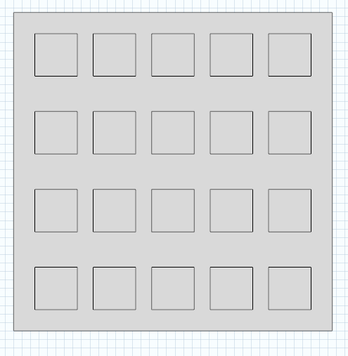

How do I select all objects in an array?
So I'm trying to build an array of squares on a workplane, where the array is of m by n dimensions (I say m and n because I want to vary them in say a parameter sweep or something). I want to subtract these array of squares from an even bigger square (see attached). Problem is that if I start out with a 3x3 array, and then I union the 3x3 array, and do (bigger square - the union of the array), I am fine for the 3x3 case. But since my union selection is going to be arr(1,1)...arr(3,3), if I change the m by n to say 5 and 4, only the arr(1,1)...arr(3,3) is selected (i.e. arr(bigger than 3, bigger than 3)) will not be selected.
So is there some way to select all the objects in an array in an automatic manner so that it is robust in parameter sweeps, regardless of size?
