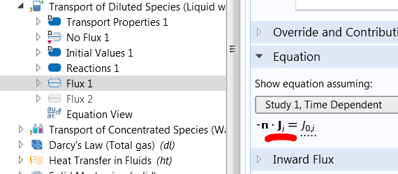

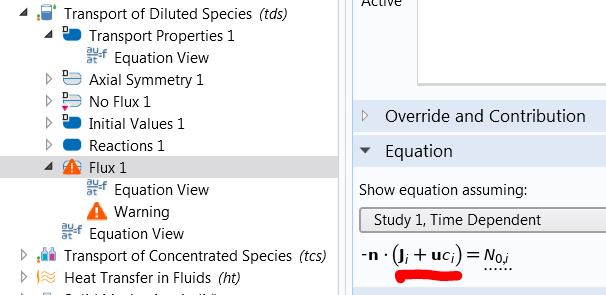

I recently noticed the flux boundary condition in the new version is different from the old versions. For the flux boundary n.j=j_0 is j in the domain always considered as the diffusive j=-D(grad c) in the newer version? If I enable convection in the domain, does this the flux automatically switch to j=-D(grad c)+uc or I will have to manually adjust for the convective flux (uc) in terms of expression of j_0?

Hi Lasse,
I am using transport of diluted species with convection and diffusion in the conservative form. There is a constant inwards flux of the species at the boundary. My question is about the default expression for the flux j inside the domain. In my understanding if I have convective and diffusive transport in the domain then, flux at the boundary j_0 = -D(gradC)+uC The expression in comsol states n.j=j_0 In the earlier versions the j in the 'Transport' was defined as -D(gradC)+uC In the new version is only diffusive flux (Screenshot attached)?
Mayuri
