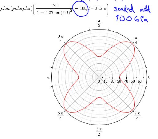

On thing to know is that the E10=E01 is around 130GPa, the E11 around 169GPa and that if you are in the perpendicular plane to <001>==z then your approximate bulk modulus can be expressed in cylindrical coordinates theta-z as E_theta[gPA]=130/(1-0.23*(sin(2*theta))^2), it makes a nice polar plot, and the anisotropic factor in the <001> plane is quite large, see attachment (scaled by 100GPa).
