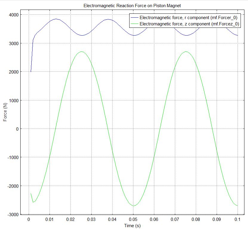

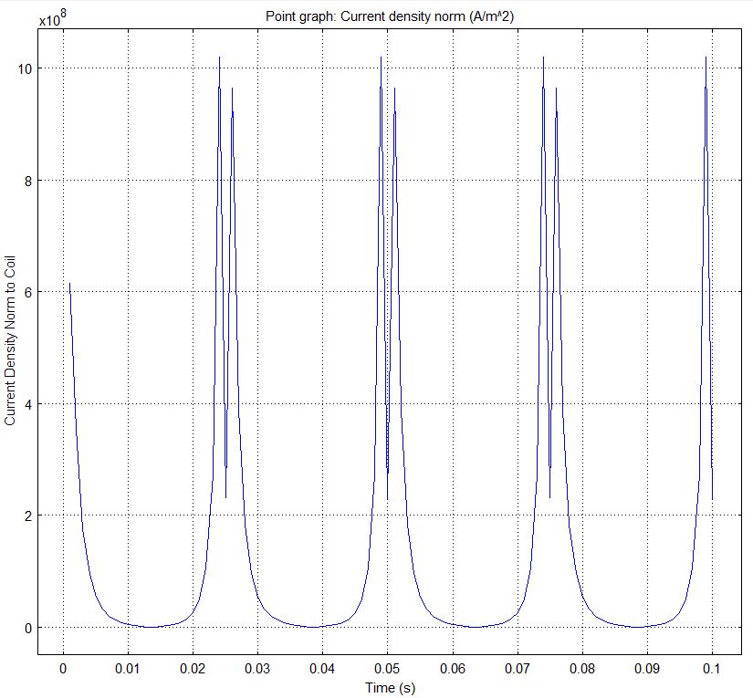

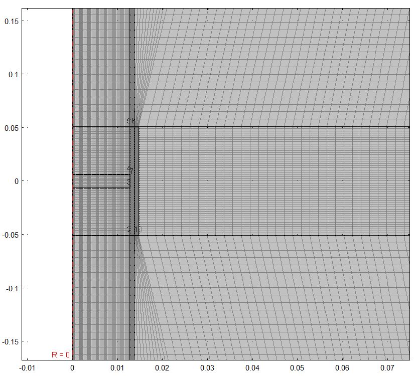

Hi everyone,
I'm facing some similar issues as well.
In my model, I have a permanent magnet (13.2 Tesla remanant flux density) moving back and forth and a fixed copper coil right next to it and I want to have the moving magnet induce a current and voltage into the fixed coil.
I initially based my model off of a CFD tutorial model for a fluid damper that has similar geometry to what I want and also uses the "Moving Mesh (ale)" module in order to move the damper piston (in my case, the magnet). I altered the tutorial model by removing the CFD physics and replacing it with MF physics and adding ampere's law to the magnet portion, as well as editing all the material properties. However, after running the simulation, I ran into some issues. With the fixed coil area part of the "Prescribed Deformation 1" for ale, I get a decent looking plot for the current density in that area (although I believe the values are a few orders of magnitude too large). If I don't select the fixed coil area as part as "Prescribed Deformation 1", I get a zero value for the current density in the coil. Is my approach to this problem correct?
Also, any suggestions on where I should put a cut point/line in the model to measure things going on in the coil (eg current density, electric field, etc)? Right now I'm using a cut point on the boundary between the coil and the magnet. My results change if I move the point just slightly to the right into the middle of the coil....
I'd like to attach the model file to clarify but the forum says its too big. What is the max size I can post and any tips on making my file smaller? I'm running 4.0a
Thanks!
-Andrew
