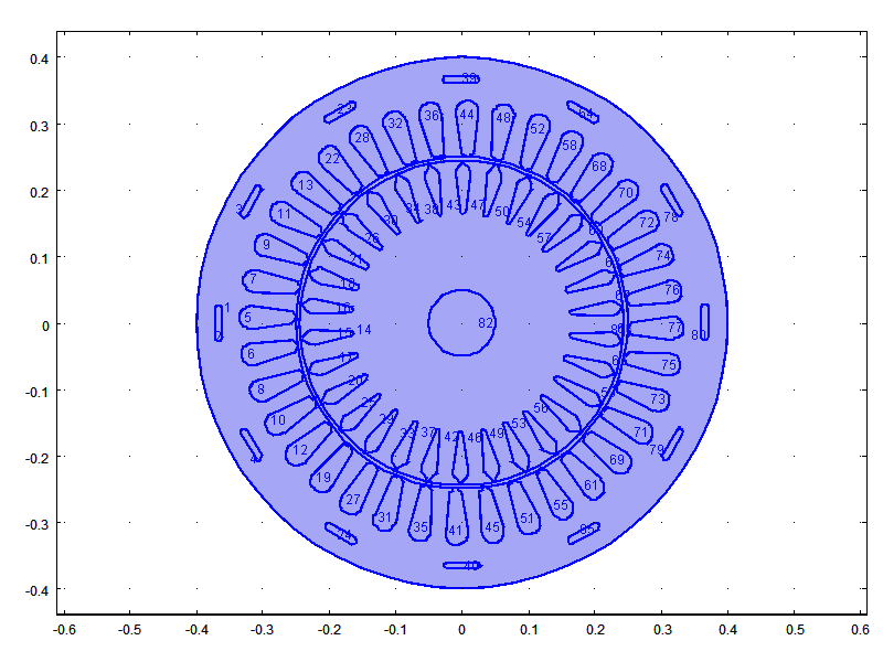

I have a model of an induction machine, which is attached in the file. In this model, besides stator and rotor laminations there are still holes located in the stator lamination that I try to make to change the rotational iron loss in the machine. These holes may be for ventilation system. Assuming that, across area of holes is kept constant. But the shape and position of these holes will influence the magnetic flux density as well as magnetic field strenght, then resulting changes on iron losses of the stator core. Therefore, to find an optimal position, we need an optimization method in the comsol model.

I also dont know why it is impossible to open with 4.2. I will try to create a model with 4.2 version. But it can open with 4.0 because I created it with 4.0 version. If you can open it you can see its area. To make it clear, I attach a picture of the model.

The position of holes (near or far from the shaft center) will affect magnetic flux density in the model. I want to find an optimal position to obtain a minimum iron loss in the stator core. That's something I try to do.

Currently, I would like to investigate the influence of holes geometry and its quantity on the iron losses of the machine. After that, using Matlab to optimize objective function with GA technique. To this end, we need an integration between Matlab and Comsol, which requires much more experiences that we need to share.
The optimization method is used to obtain maximum heat flux and minimum iron losses in the model. If anyone who has exprienced some similar projects, please give me a help.
