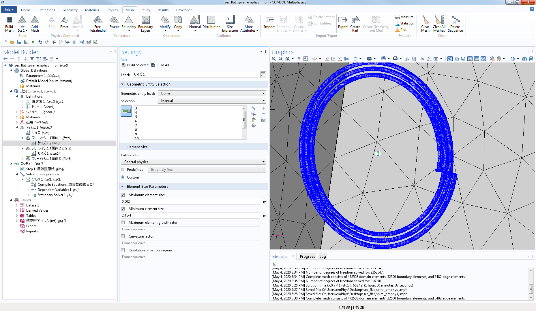

I played a little with your iterative setup and with a little mesh refinement on the coil domain it converges. It took 450 iterations and almost 2 hours on my machine, but needs less than 13 GB then. Maybe you can tweak that a little. The screen shot shows the only modification I did to the mesh. I didn't touch the solver. This is the model you posted first.
Cheers Edgar

Thank you for your teaching. I tried to change the mesh like your screen shot. But It did not converge. I will try other meshes.
Is my understanding correct with that, In iterative solvers, finer meshes tend to converge?
And, is there any other effective way to converge?
My purpose is to compute more complex 3D models. However, this relatively simple model does not converge. Do I need to change something fundamentally to compute complex models? For example, machines, calculation methods, modeling methods, etc.
