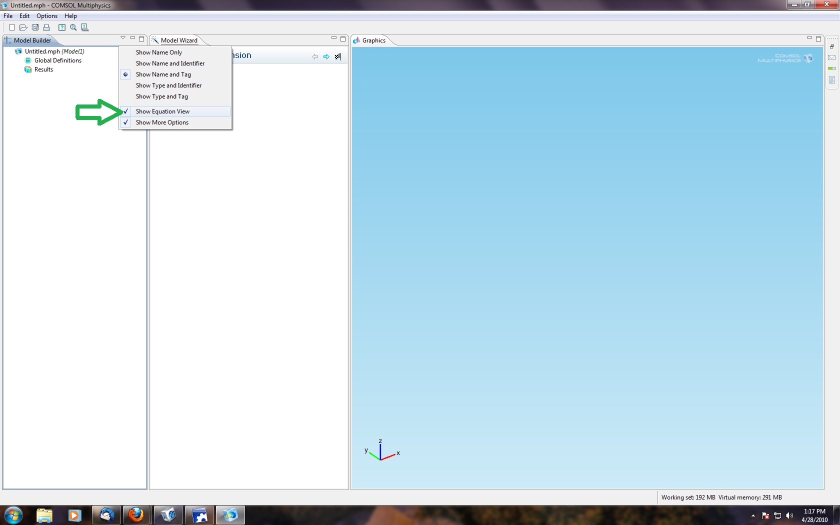

I see on this chain that I can use Matlab to read the stiffness matrix out of COMSOL and then conceivably identify the error that is causing a residual to be NaN.
But where to begin? I can download a trial version of Matlab from Mathworks. Which modules do I need? Matlab presumably. How about Simulink? Any others? I guess the latest version of Matlab works with COMSOL 4.0?
Thanks, John
p.s. Is anyone else on COMSOL 4.0 having trouble seeing the equations?? Yes, I've clicked on show equations, and I click on "Update Equation View". But the only things to ever show up are the constraints. Once, on a k-e, I got loads of equations to show up on a boundary condition, but this is a rare event.
I see on this chain that I can use Matlab to read the stiffness matrix out of COMSOL and then conceivably identify the error that is causing a residual to be NaN. But where to begin? I can download a trial version of Matlab from Mathworks. Which modules do I need? Matlab presumably. How about Simulink? Any others? I guess the latest version of Matlab works with COMSOL 4.0? Thanks, John p.s. Is anyone else on COMSOL 4.0 having trouble seeing the equations?? Yes, I've clicked on show equations, and I click on "Update Equation View". But the only things to ever show up are the constraints. Once, on a k-e, I got loads of equations to show up on a boundary condition, but this is a rare event.

for the equation, the "upper level" is not yet implemented, but the "lower level" is there see file
