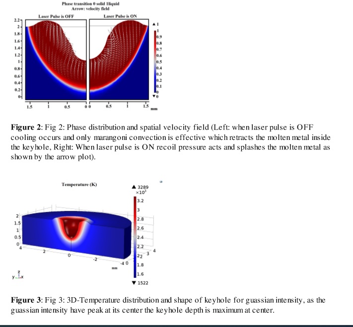

How can I best recreate this effect on the picture? Using Gaussian function, but how can I deform the material? Please give advice.
