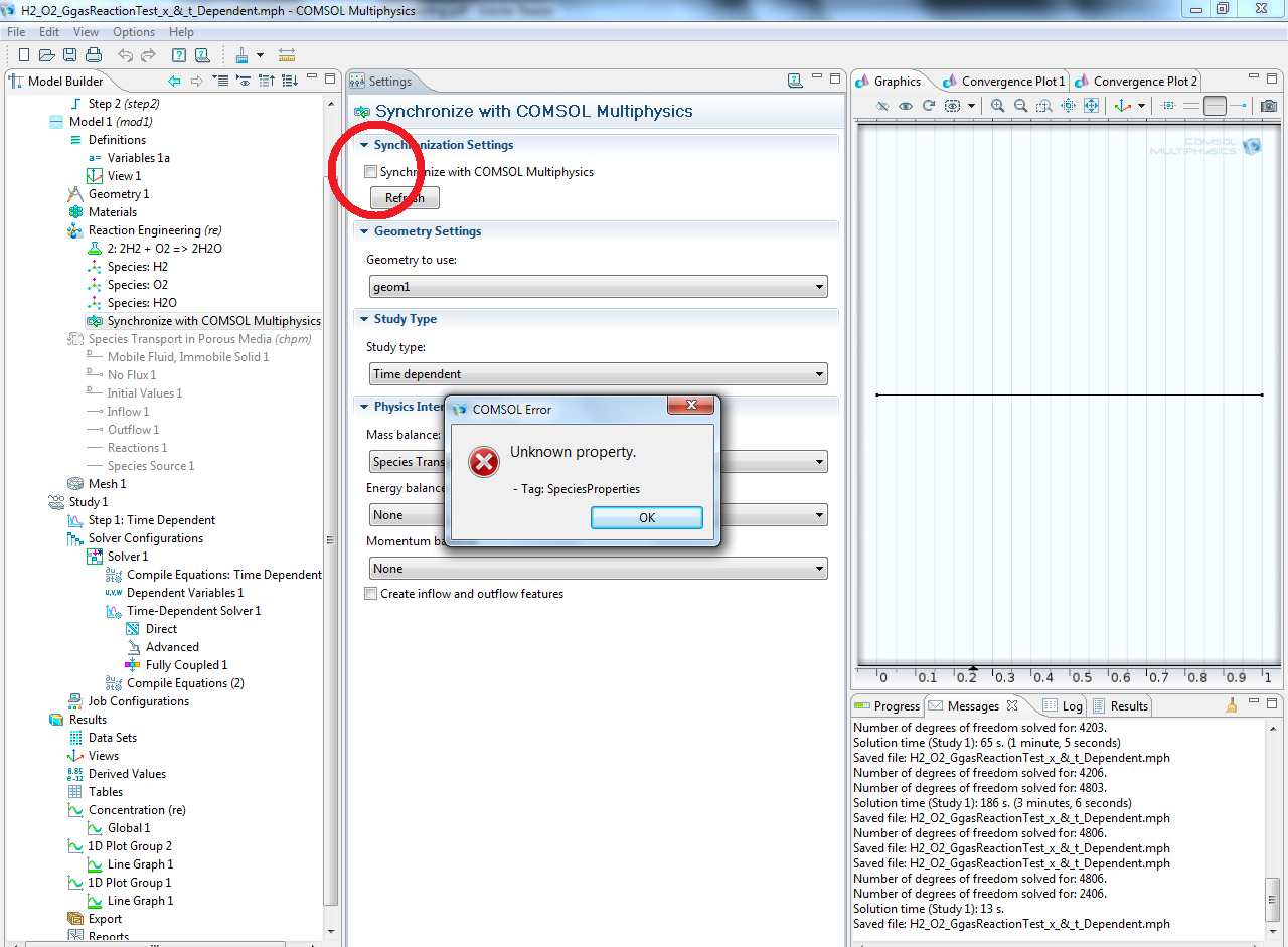

I have a question about the chemical engineering module (re) (1D). For testing purposes I modeled the reaction:
2H2 + O2 => 2H2O and this works on its own (no coupling or whatever) as a CISTR, fine.
But I want this to happen inside a porous reactor, in the gas phase. So I made 'Species Transport in Porous Media (chpm)' and I can model flow of species through the medium, also fine. But when I try to model every element as a CSTR, using the chemical engineering module to calculate the reaction, it does not work.
First of all, I don't really understand how to couple the concentrations. (re) uses H2, O2 and H2O, but (chpm) uses c_H2, c_O2, c_H2O, how do the two understand this is the same? Also, when I try to couple the two using 'Synchronize with COMSOL Physics' I get a really vague error (see picture).
In words: Unknown Property Tag:SpeciesProperties, But it doesn't say what property!
I checked the demo models and the forum and the knowledge base but I don't see the answer to this problem.
Any suggestions on how to model this kind of thing?

Comsol creats a variable for concentration as soon as you check the box for Synchronize . I have same problem in v 4.0a too, the variable is c(species name) and it is a bridge for the two seperate interfaces and I don t know why it can not be distinguished when you are utilizing synchronization.
I have not solved it yet eather, please give me the answer as soon as you fiound it out.

Synchronization also do not work for me in 4.2a. I request COMSOL people to resolve this issue on priority.
