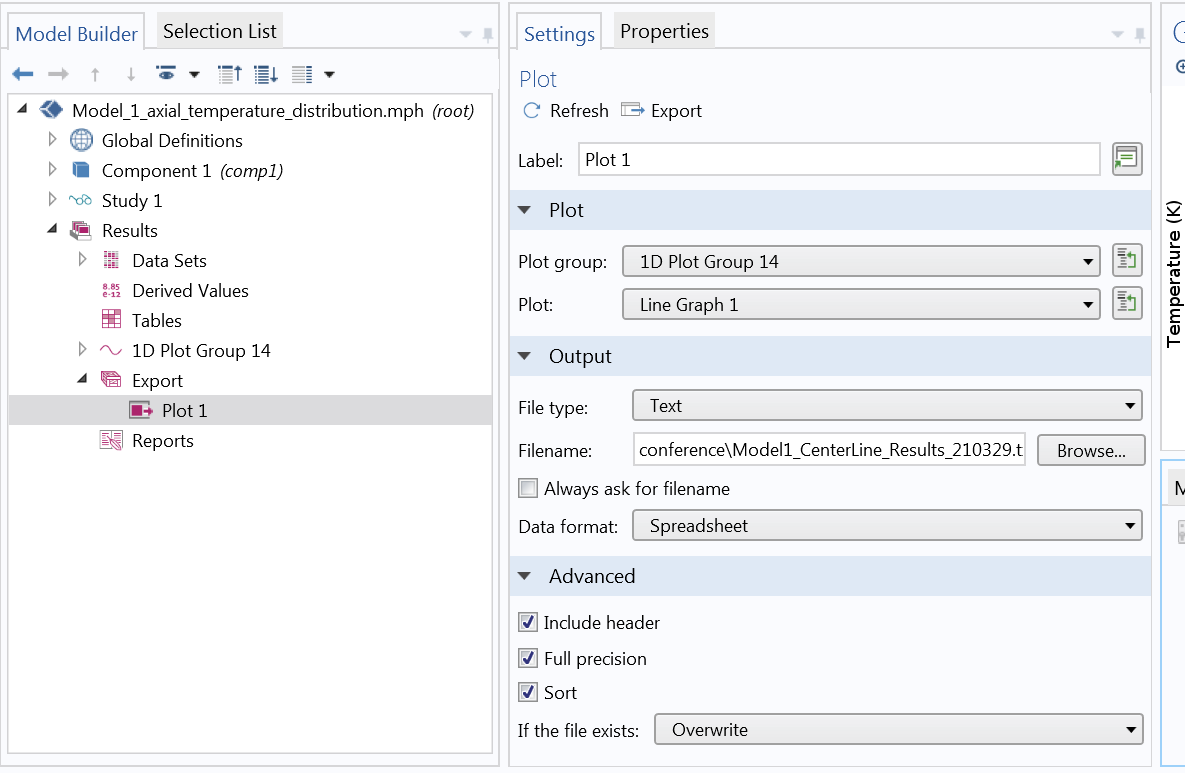

Hi all, I'm running a time dependent study to calculate temperature of a model, with multiple (3) values for a single parameter. I'm interested in studying how temperature changes along a line in the model through time, for all 3 parameter values.
I created a cut line 3d and then a 1d plot group to look at temperature along the line. When I export the data as a text file, it outputs two columns, arc length along the line, and corresponding temperature. The values of arc length along the line repeat periodically, I assume for different temperatures / parameter value combinations. But it would be a lot easier to understand the data if I had corresponding columns for time and parameter value.
Does anyone know how this can be added to the exported data? Or can I assume the data is presented such that all times for the first parameter are shown first, then all times for the second parameter, etc.?
