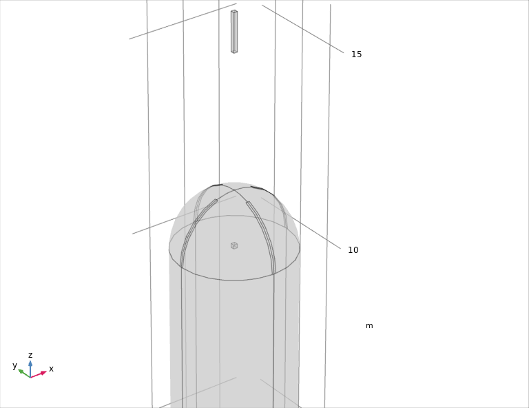

Hi Jeff,
I have thicken the strip and want it lying on the surface of the sphere but am not successful. Is there a way to heighten the strips without compromising the geometry design?
Could you show me an example with version 5.4 ? As I could not open your attached mph file with an outdated version.
Attached is my mph file of my model. Maybe you could use my file as an example. V1 is an updated model for better visualisation with thicken strips. However, I could not make the strips lie on the surface of the outer sphere for this model.

Hello Ian,
It sounds like the license you are using does not include the Design Module. The Design Module is an optional add-on product. You can check whether your license includes that product by going to File > Licensed and Used Products.
In any case, I do not have version 5.4 any longer. I would encourage you to update your installation to the current version, for which I'll mention in passing that you'll get better support than for an older version, whether that's under a support contract from COMSOL's official support service or from other users in the Discussion Forum.
