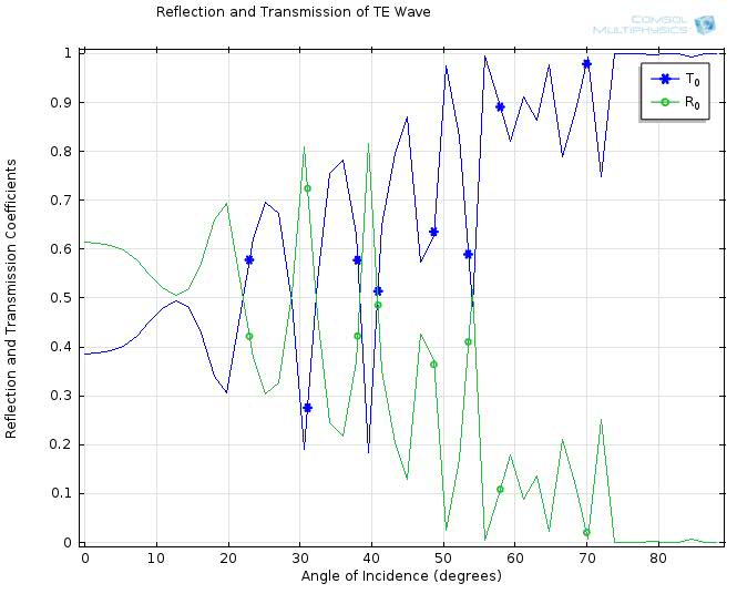

Posted: 1 decade ago 15.05.2012, 21:18 MESZ
Hello Alexander,
I upload one pic on my calculation. It polted the relation btw the R/T coefficients with incident angle. I attempeted to change the size of the mesh and these oscillation still exists.
It is the oscillation that caused me to use the PML+scattering field to calculate the R/T coefficients of the grating, not "Port".

Posted: 1 decade ago 16.05.2012, 20:50 MESZ
Hello Alexander,
Are you sure they are coming from ports? Way to check it is to shift your port by quarter-wavelength further away from the grating and see if the results changes. If that's the case, then I suspect that you didn't setup ports correctly. By looking at your grating, ports should work just fine.
[QUOTE] Hello Alexander, I upload one pic on my calculation. It polted the relation btw the R/T coefficients with incident angle. I attempeted to change the size of the mesh and these oscillation still exists. It is the oscillation that caused me to use the PML+scattering field to calculate the R/T coefficients of the grating, not "Port". [/QUOTE] Are you sure they are coming from ports? Way to check it is to shift your port by quarter-wavelength further away from the grating and see if the results changes. If that's the case, then I suspect that you didn't setup ports correctly. By looking at your grating, ports should work just fine.
