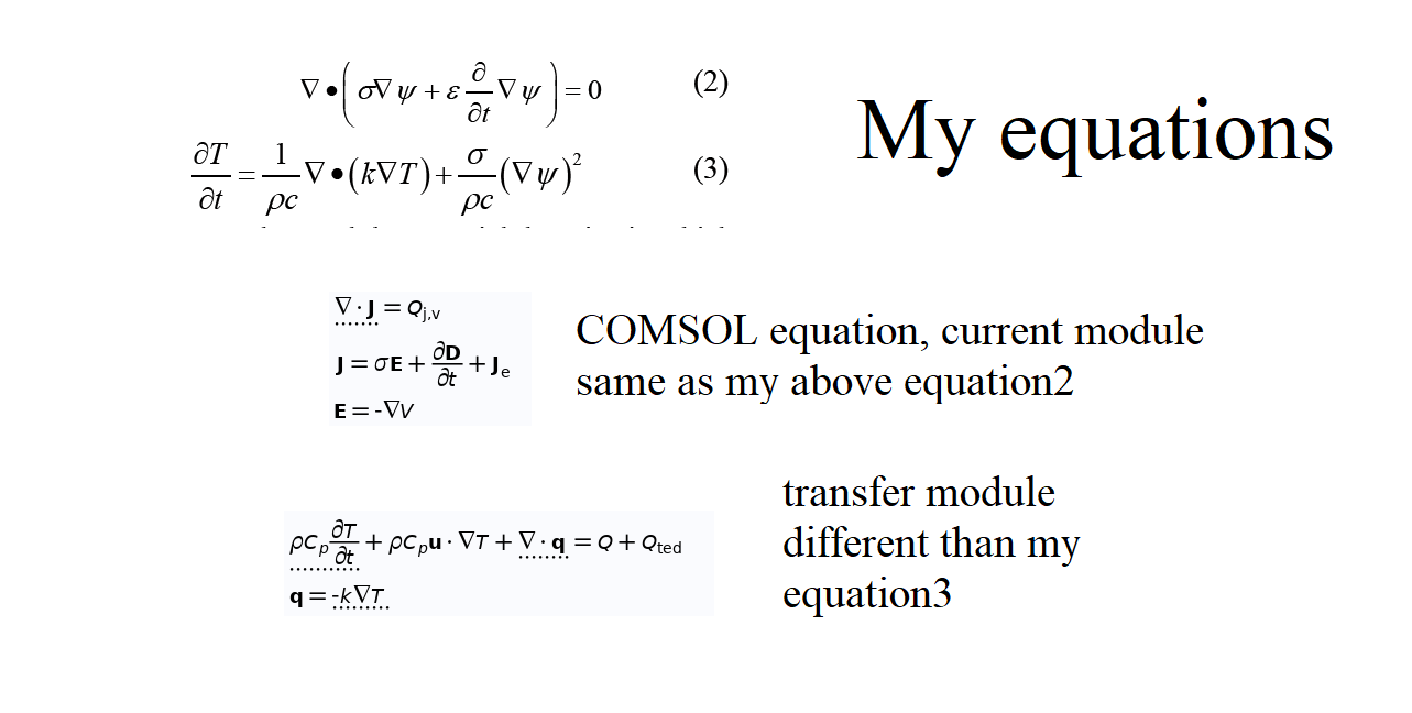

I have a question regarding a model I am trying to bulid. I would like to couple Electric current and heat transfer modules to solve a problem. The physics of my problem has two equations which I have them in image one (Eq.2, and Eq.3). However, when I compare them with comsol equations, the electric current looks like my current equation (Eq.2), but the hea transfer module does not have the term associated (sigma/roCp)(gradient potential)^2. Instead comsol has roCpu. (gradient temperature). I was wondering if I am making a mistake? how can I tackle this problem. Thank you so much.
