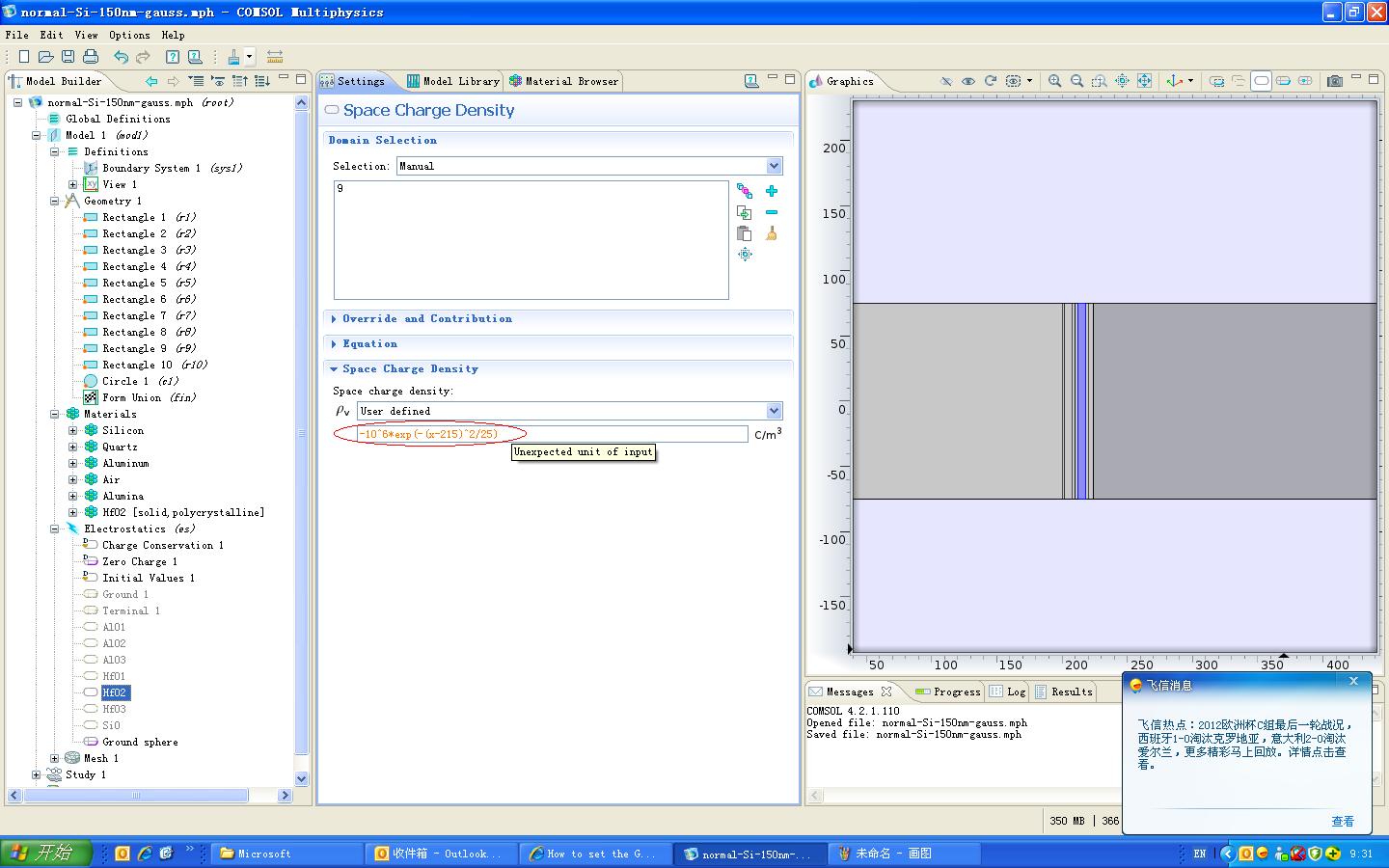

I am a freshman here. I want to simulate the potential map of a simple capacitor with a Gauss charge distribution. The model is simple but I do not know how to define the charge distribution such as -10e6*exp(-x^2/25)C/cm3. I can only set a fixed value in the "space charge density". When I try to write a Gauss expression with the variable "x", it always says "unexpected unit".
What can I do?

Thank you very much for your quick reply.
But I can not set the unit since the default unit of charge is C/cm3 and fixed by COMSOL.
Pls see the attached image. I highlight the problem shown.
PS. It is a 2D modle and left and right parts are electrodes. The dielectric is in the middle.

You can override the unit. Just insert "[C/cm^3]" behind the "10^6" factor or at the end of the expression. Only if you don't specify a unit, the default unit displayed in the right margin is used.
However, as you can tell from this explanation, the unit of the pre-exponential factor is not the issue here. Rather, you're dividing x^2 (which has unit m²) by something unitless in the exponential, so your overall unit is exp(m²), which is what throws Comsol. Instead of dividing by 25, you should divide by something like "(5[m])^2" to get the units right.
Other than that, it's usually safe to ignore the unit warnings, if you know what you're doing. After all, the solver just deals with numbers.
You can override the unit. Just insert "[C/cm^3]" behind the "10^6" factor or at the end of the expression. Only if you don't specify a unit, the default unit displayed in the right margin is used. However, as you can tell from this explanation, the unit of the pre-exponential factor is not the issue here. Rather, you're dividing x^2 (which has unit m²) by something unitless in the exponential, so your overall unit is exp(m²), which is what throws Comsol. Instead of dividing by 25, you should divide by something like "(5[m])^2" to get the units right. Other than that, it's usually safe to ignore the unit warnings, if you know what you're doing. After all, the solver just deals with numbers.

Yeah!
I get it. Thank you very very much.
Yeah! I get it. Thank you very very much.
