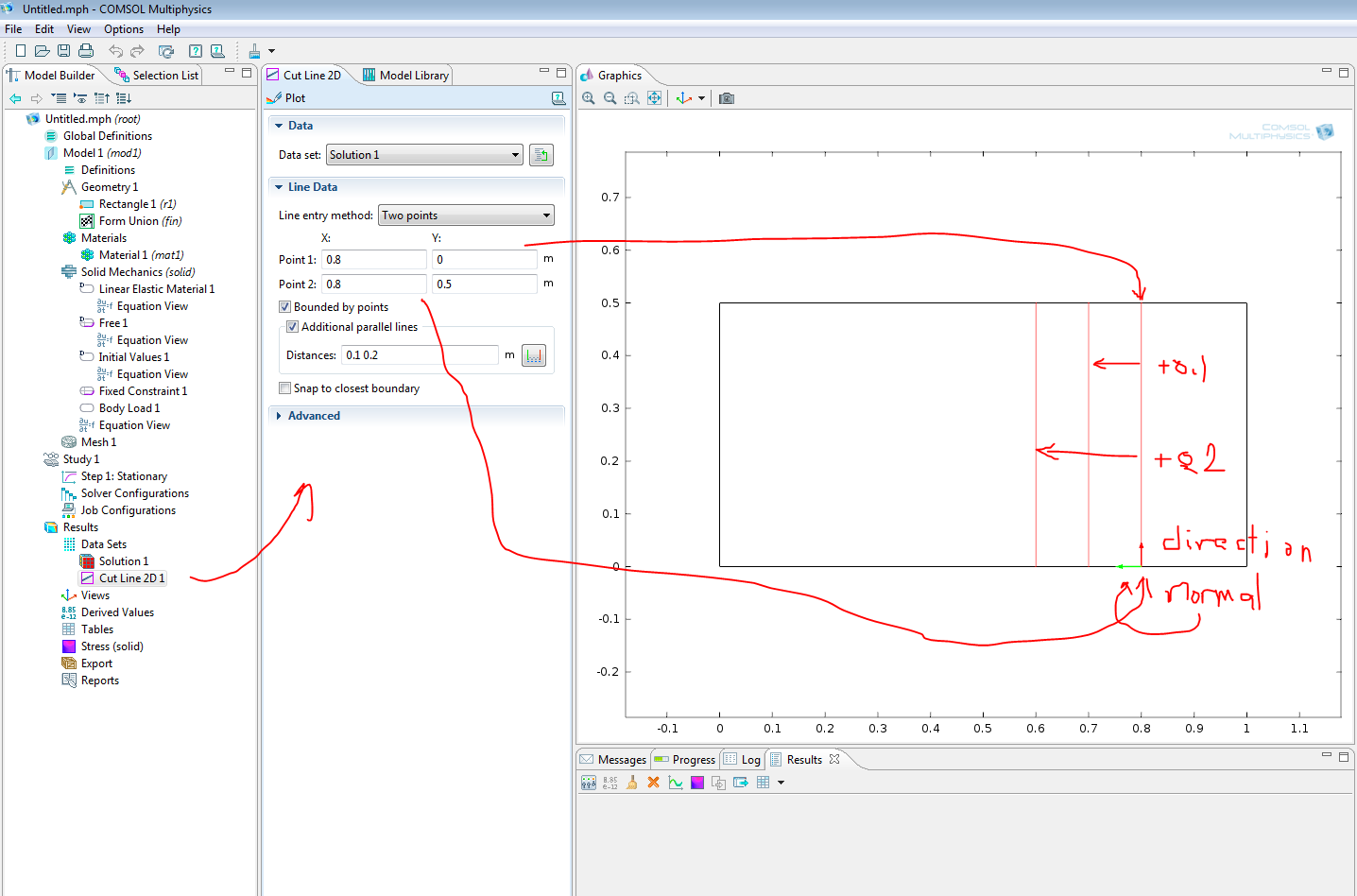

Posted: 1 decade ago 28.06.2012, 15:49 MESZ
that is normally the coordinates reference marker, you should define the line start and stop points and then add select additional lines
at least in 4.3 you get the red arrow showing the direction and the green the normal direction hence positive displacements for your additional line values
Hi that is normally the coordinates reference marker, you should define the line start and stop points and then add select additional lines at least in 4.3 you get the red arrow showing the direction and the green the normal direction hence positive displacements for your additional line values -- Good luck Ivar
