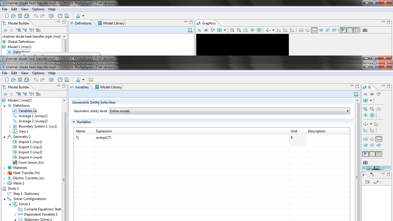

You can always define a global MyT as aveop1(T) over some domain or oundary nad decide to link some of your dependences on "T" to MyT, then you force the same scalar value MyT to all elements defined

well I found a way to bypass this thing and it works . before I was using joule heating and now I am only considering my problem as a heat transfer one. :) . That somehow solves my problem.
But still I am struggling with the second problem. I am using a probe for the second problem. But the probe can what I have seen only integrate or sum but I want the probe to be updated all the time and it will act as a variable. what am I doing wrong.

about the second problem, I tried your way and I think, it is working quite fine.. you are a life saver.. thanks a lot

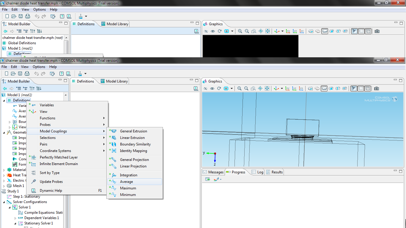

so, for example, if I want the average of the concentration in a domain, I go to Detinitions-Model Couplings-Average, I choose the domain and then in the operator name, I write:
aveop1(c), but then it says
"Invalid property value
-Property: opname "Operator name" is a string. Must be a valid variable name"

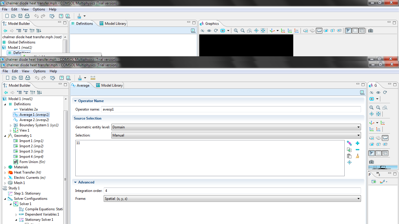

I think I got it, first I just simply define the average operation, I create aveop1 selecting my domain.
Then I create a variable for that specific domain, for example:
c aveop1(c1)
and now I can have all my properties in function of the average concentration "c" , like
rho (density)=(1+0.00934*c)*(A+B+C)
Am I right??

that was exaclty what I tried to write. I think it is working now. Thank you very much for your help.
