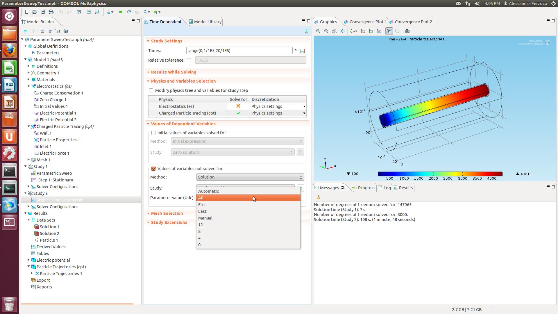

Thank you for your suggestions. I made a very simple model in 4.3a, but I fear I am still struggling with the parametric sweep.
The model is two electrostatic lenses with charged particles flying between them. The electric field is calculated using Electrostatics physics and a stationary study. The charged particle trajectories are calculated with a time-dependent study that uses the ES solution for values for dependent variables.
If I sweep the value of the potential (called Udc) on a lens in the stationary ES study, the CPT study gives me an option to select one or all of the parameter values. This is shown in the attached screenshot. The CPT calculation is successful if I choose an individual parameter. However if I choose "All" from this menu, the calculation is only performed using the last parameter of the sweep in the ES study.
I am able to sweep Udc if I include the ES physics in the time-dependent calculation. However the calculation takes unreasonably long because it recalculates the electric field at every time step.
To me it seems like this drop down menu is the obvious selection for using the ES parameter sweep in the CPT calculation, but perhaps I am missing a necessary part of the procedure?
Thank you again for your suggestions.
Thank you for your suggestions. I made a very simple model in 4.3a, but I fear I am still struggling with the parametric sweep. The model is two electrostatic lenses with charged particles flying between them. The electric field is calculated using Electrostatics physics and a stationary study. The charged particle trajectories are calculated with a time-dependent study that uses the ES solution for values for dependent variables. If I sweep the value of the potential (called Udc) on a lens in the stationary ES study, the CPT study gives me an option to select one or all of the parameter values. This is shown in the attached screenshot. The CPT calculation is successful if I choose an individual parameter. However if I choose "All" from this menu, the calculation is only performed using the last parameter of the sweep in the ES study. I am able to sweep Udc if I include the ES physics in the time-dependent calculation. However the calculation takes unreasonably long because it recalculates the electric field at every time step. To me it seems like this drop down menu is the obvious selection for using the ES parameter sweep in the CPT calculation, but perhaps I am missing a necessary part of the procedure? Thank you again for your suggestions.
Daniel Smith COMSOL Employee
Posted: 1 decade ago 09.11.2012, 22:47 MEZ
Hi, you have to perform both study steps within the same study. To do this, remove study 2. Then right click on Study 1 and choose Study Steps>Time Dependent. If you regenerate the solver sequence on Study 1, the particle tracing will use the correct field values in the sweep.
