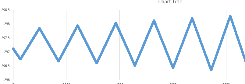

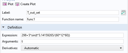

Hi, I'm trying to specify a time dependent sinusoidal temperature boundary condition. I've defined a function in the screenshot attached. However, when I run a time dependent solver, the temperature of the boundary I've defined comes out looking jagged and not steady as seen in the second screenshot. How do I fix this issue?

you probably need to adjust the time stepping. For periodic signals you should set manual time steps that resolve the waveform. The automatic time stepping ignores the periodicity of the waveform. This is about the time steps in the solver, not the time steps you set in the study step.

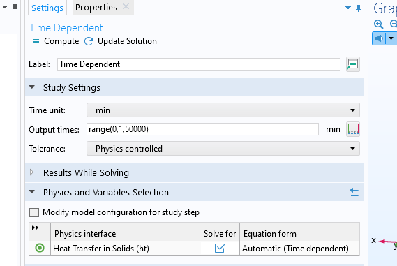

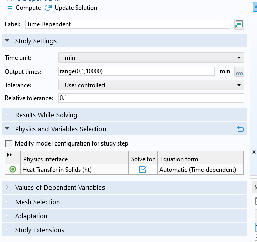

Hi Edgar, How do you set manual time steps? I've tried both of these (attached) in the time solver. Thanks, Sarah

Those are the settings in the study step.
You need to change the time stepping in the solver. That is in Solver Configurations -> Time Dependent Solver -> Time Stepping

What exactly would you recommend I change in the time stepping? I've set steps taken by solver to manual but not sure what to put for the other inputs.

You need to resolve the waveform. I would recommend to start with period/10, so for a 50 Hz waveform with a 20 ms period it would be 2 ms. Depending on your results you may relax that to a longer time step.
