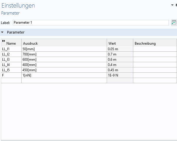

image_6.png,image_7.png shows the values set initially and the adjacent screenshot shows the scaled value with units in µm ** screenshot attached **

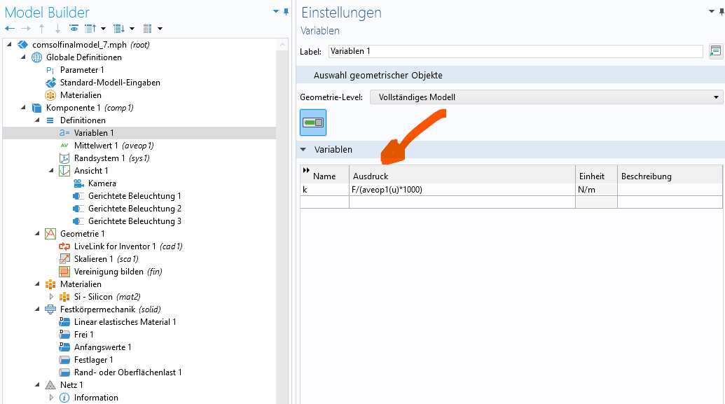

Image_5.png We defined the formula of K and used a scale factor .001 or 1/1000 *(F/aveop1(u)) ** screenshot attached **

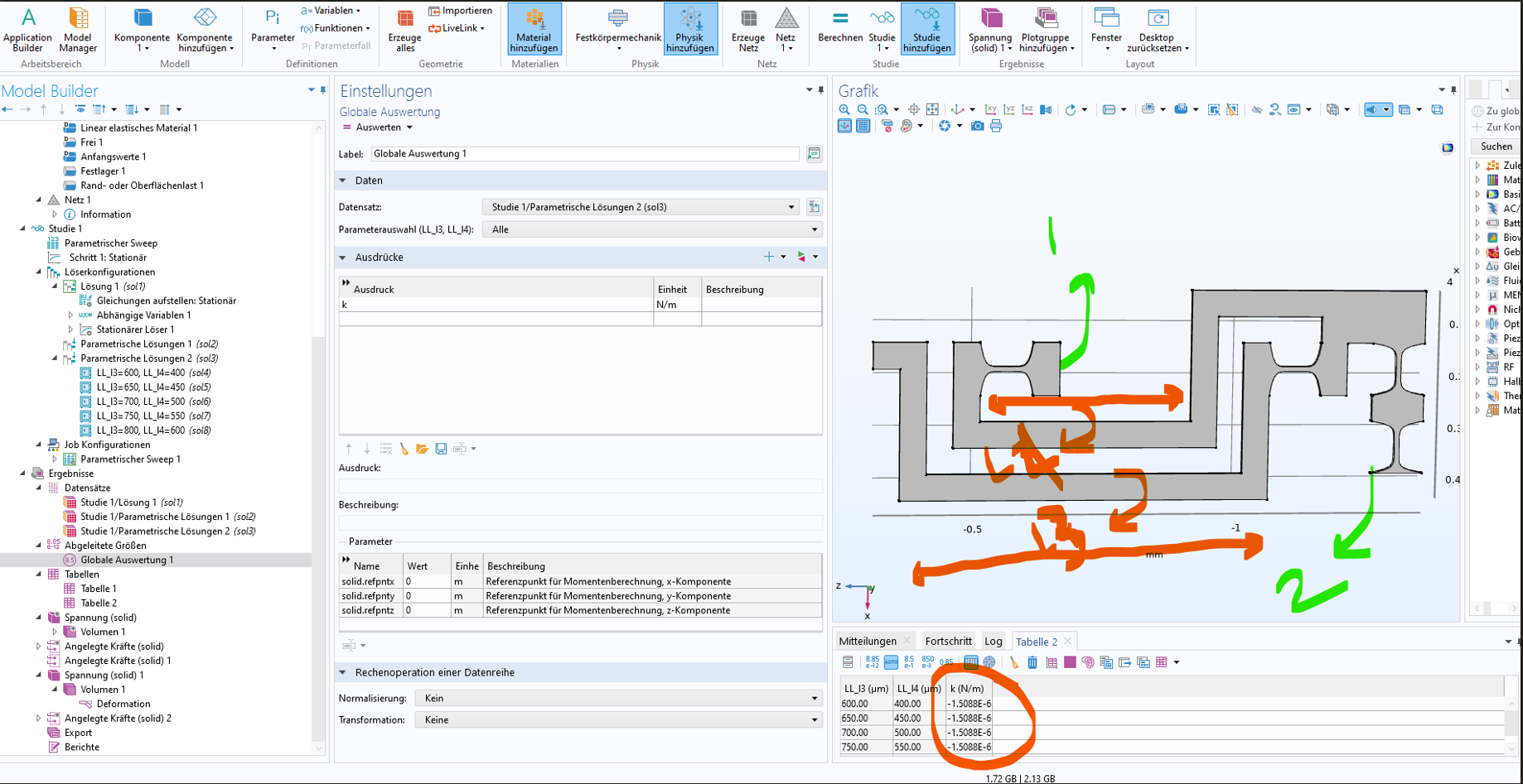

Image_4.png As it can be seen in the underlying results , the value of K is same even for different combination of parameter lengths l3 and l4.
1 is fixed hinge point and 2 is the point of the force application (both are marked in green color in the below screenshot)
Therefore, we want to understand why we are getting same values of** K(-1.5 * 10^-6)** even when the parameter lengths are varied?This is strange, is there some settings i need to select or i am missing something , please suggest.
The highlighted result is shown in the below screenshot in the bottom right(marked in red circle). ** screenshot attached **
How can we fix this error and get different values when we change the parameters , please advice? The value of K should vary with change in l3,l4 (image_4.png) . I have added all the screenshots for your reference in the attachment section.

A possibility is that there is nothing wrong with your model set-up and that k is in fact not very sensitive to changes in l3 and l4 that keep l3/l4 more or less constant. But I understand that that is not what you are expecting. I don't think it's possible to give you a satisfactory answer without playing with your mph file (For instance, you didn't show how you defined aveop1). You may want to upload it, with the mesh and solution cleared.

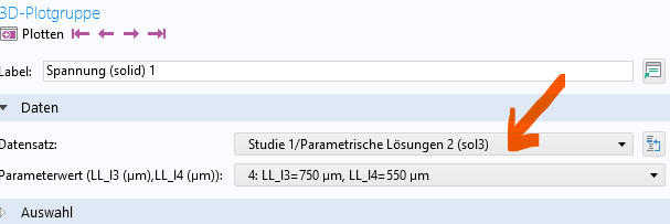

PS: Have you checked that the dimensions l3 and l4 are indeed updated when they are supposed to in the plots?
