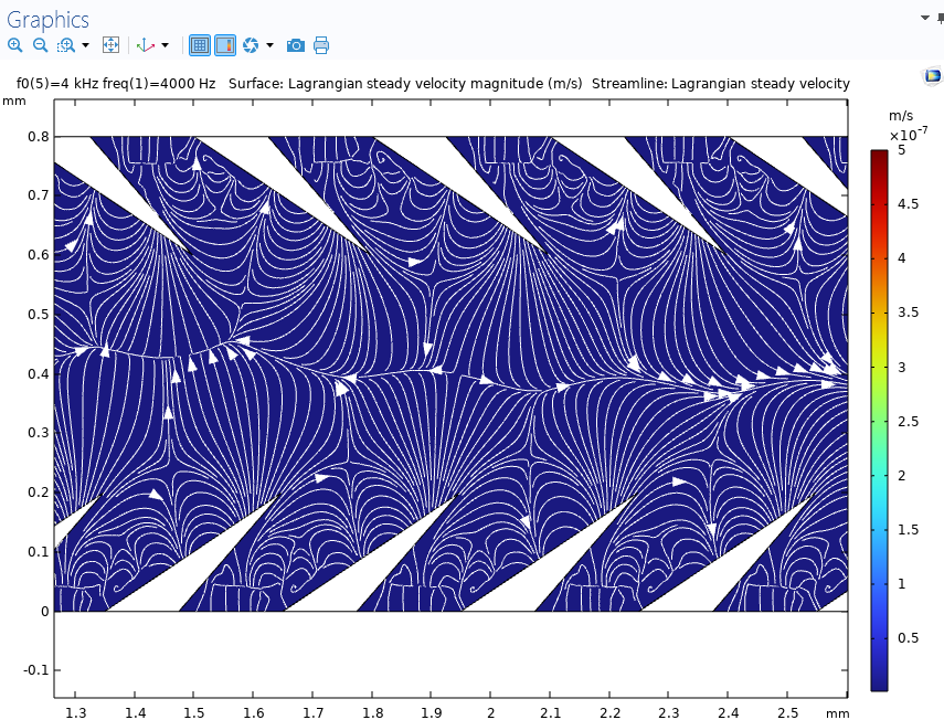

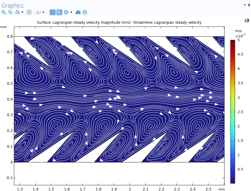

Hi Edgar,
Thanks for the response. That definitely makes sense and seems to be solving as intended now in terms of getting stationary results for each frequency, but I am getting some very weird results that are different to when I solved them in two separate studies. I am unsure if this is due to it solving the physics differently/wrong but it is definitely different to the results I get when solving in separate studies (which agree much more with literature). I have attached the streamline plots underneath. As far as I can tell the study step itself is identical to the one I used when they were separate studies so I'm a bit lost as to why there is such a big change. Thansk again for your help.
Cheers,
Ricky
Hi Edgar, Thanks for the response. That definitely makes sense and seems to be solving as intended now in terms of getting stationary results for each frequency, but I am getting some very weird results that are different to when I solved them in two separate studies. I am unsure if this is due to it solving the physics differently/wrong but it is definitely different to the results I get when solving in separate studies (which agree much more with literature). I have attached the streamline plots underneath. As far as I can tell the study step itself is identical to the one I used when they were separate studies so I'm a bit lost as to why there is such a big change. Thansk again for your help. Cheers, Ricky
Posted: 1 year ago 05.07.2024, 10:04 GMT-4
Weirdly enough I just restarted a new study to see if there was some hidden setting I'd accidentally changed somewhere in the old version everything seems to be working now which is a bit weird but I'll take it. Thanks for the support!
Cheers,
Ricky
