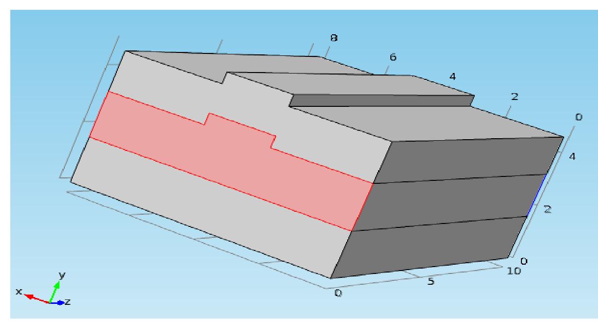

Posted: 1 decade ago 19.01.2013, 14:19 MEZ
Hi Alexander
Thanks for your response
I send you the schematic file and marked the 7 boundary.
Thanks in advance
Hi Alexander Thanks for your response I send you the schematic file and marked the 7 boundary. Thanks in advance
Posted: 1 decade ago 21.01.2013, 18:42 MEZ
What's the BC on boundary 7?
