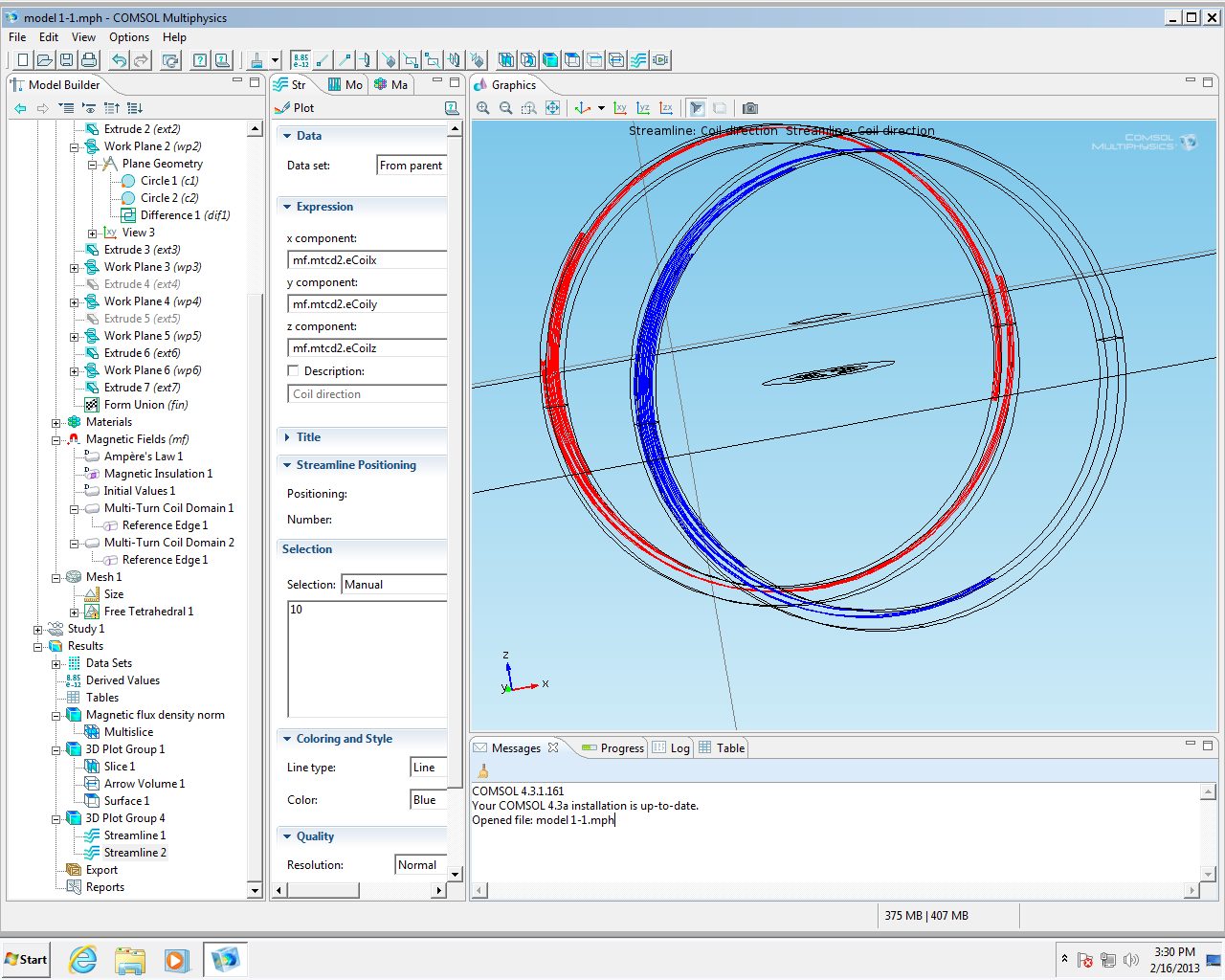

it looks like you used a geometry parameter for the components of the flux lines. You must use the magnetic flux density components instead and assign proper start coordinates.

I have another question for my model. in this Helmholtz coil, i build another permanent magnet at the center of this coil system. Do I need to edit something about interface or sth else? I built another mesh for the permanent magnet and I am able to compute. But when I was trying to plot the 3D arrow volume for this permanent magnet, it gives me a error saying "failed to evaluate variable :mod1.mfnc.Bx". I am not sure how to fix this. And also, when i did slice for this magnet as how i did it for the helmholtz coil, it didn't give me a error but there is nothing plotted on the model either. I feel like I am missing something here when I add this permanent magnet. Can you tell me what I did wrong here?

I have followed another post and made some changes to my model. and now i have things shown for arrow,slice and streamline for the permanent magnet. But the plot doesn't really look reasonable to me. is there anyway I can send this file to you and you can take a look at it for me? (the file size is too big it won't let me attach it). maybe you can help me find out what i did wrong after you look at my file.
and also, at first, i thought i should choose magnetic field, no current for the magnet, like it is said for model 78,but when i used that, it shows me a error that the variable mfnc.Bx can not found. then I changed to magnetic field(like said in another post), things show up but weird. which exactly should I choose for the permanent magnet?
Thank you in advance for your help!

I have attached my file below. What I did for this model is I have a mesh for the Helmholtz coil and one for the permanent magnet(zone 7). and I also have another setup to generate another magnetic field below the permanent magnet(I disable that for now). Can you check the parameters and properties I choose for both the Helmholtz coil and permanent magnet? The plots for these model is really important for my research. Thank you for you help!
you should start to use only 1 MF as now you solve for two magnetic vector potentials over the same model, but these are not linked
Yes Ivar is right. I moved the permanent magnet's Ampere's Law into the first mf model (where the coils are defined) and it looks good to my taste. I assume you want to see the interaction between coils and magnet?

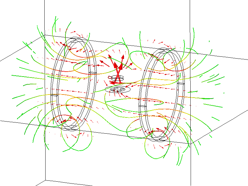

I have modified your model; is this what you are looking for?

Sorry for the late reply. and YES! it is what I am looking for (by looking at the .png picture). but somehow, when I opened the mph file, i can't see anything in the graphic. Do you know why?...... and also, what changes you have made to the model to make it looks like this? Can you also explain why? Thanks a lot!
Celia
You have to solve it again; the model is clean (deleted mesh and solution to keep the file small).
As Ivar said I use only one MF physic to define all things.
Look at the 3D plotgroup 2 how the definition of streamlines is used (also limits for data range and color...).
Ralf
I resolved the model as you said and now I got the graph you did. it look good! thank you!

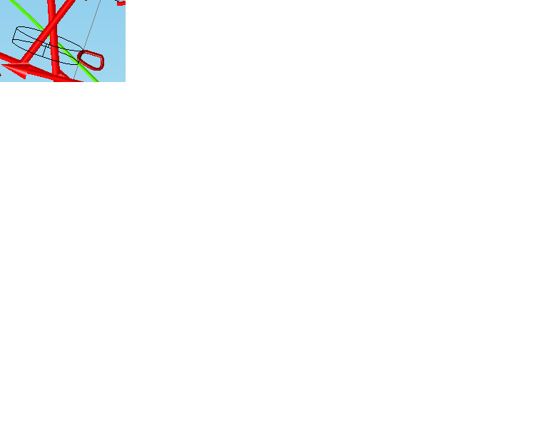

and also, what is the little circular thing attach to the cylinder in the middle? (i have attached a screen shot of it)

Yes, the solution is for all parts; they produce one mag. field.
The little ring is one streamline. Since you have a strong magnet and a little coil current, the field from the magnet is much stronger. My streamlines depend on field strength...
If you increase the currents from 5 to 50A, you will see better images. Play with streamline parameters - you have several options!
The arrows will show you the orientation of the magnet. If you reverse the magnetization, the arrows near the magnet will also be reversed.

The arrow for the orientation of the permanent magnet, can you be more specific? are you talking about the red ones in the field or the one I have attached on my previous reply? Btw, what is the little red thing attached at the side of the permanent magnet?
