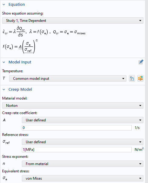

The best approach is to reformulate the problem, so that you use an auxiliary reference value.
Attached is a screenshot showing how this is handled for the built-in Norton creep law. Usually this law is written as
where is the strain, is the stress, and n is a power that is usually not an integer. This causes the coefficient A to have awkward units. (There are other problems too, for example you must know the unit in which the stress is measured.)
In order to avoid non-integer powers of units, we introduce an arbitrary reference stress, so that the equation is transformed into
Then, A will always have the unit 1/s. It will also not change its value if you change the unit system for the stress.
Henrik Sönnerlind
COMSOL
The best approach is to reformulate the problem, so that you use an auxiliary reference value. Attached is a screenshot showing how this is handled for the built-in Norton creep law. Usually this law is written as \frac {d \varepsilon}{dt} = A \sigma^n where \varepsilon is the strain, \sigma is the stress, and *n* is a power that is usually not an integer. This causes the coefficient *A* to have awkward units. (There are other problems too, for example you must know the unit in which the stress is measured.) In order to avoid non-integer powers of units, we introduce an arbitrary reference stress, so that the equation is transformed into \frac {d \varepsilon}{dt} = A (\frac{\sigma}{\sigma_{ref}})^n Then, *A* will always have the unit 1/s. It will also not change its value if you change the unit system for the stress.
