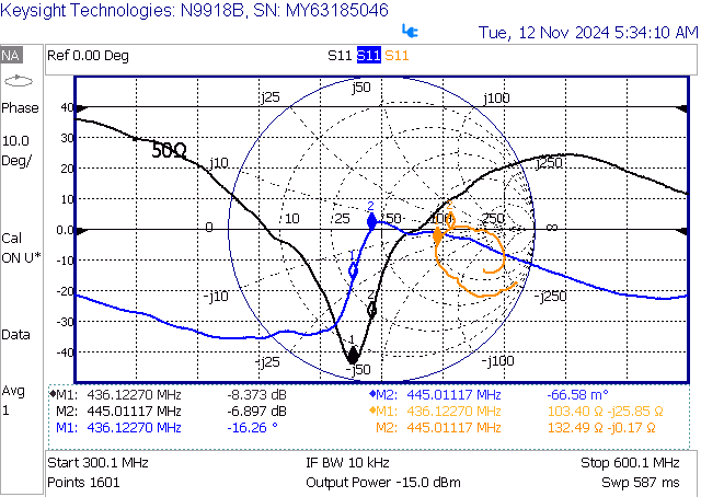

I managed to get negative S11 values. Though it doesnt seem to go as deep as the reference project suggests.
![https://gusbertianalog.com/content/images/2024/11/MEAS_ROUND_CCC.png]
https://gusbertianalog.com/loop-antenna-design/
