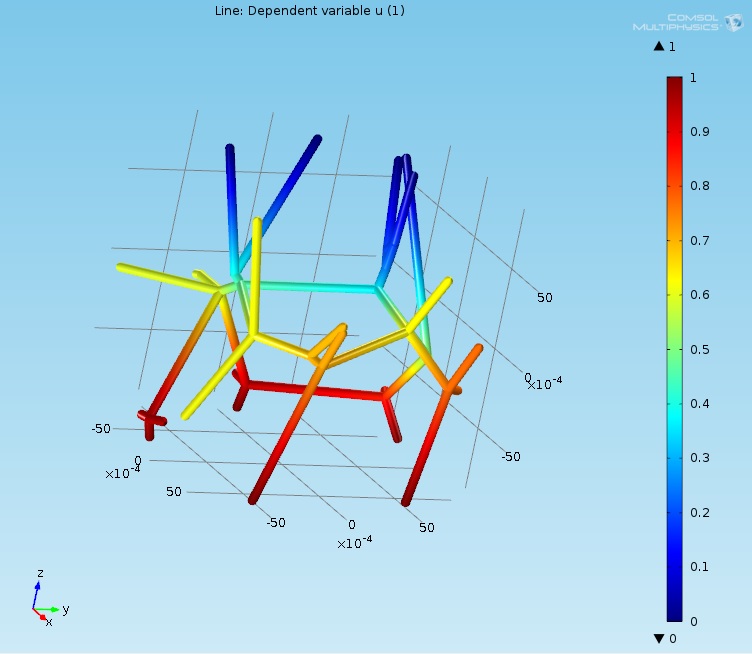

I have a network of 1D elements and I have modeled the current flow inside them using Coefficient from edge PDE. So after running the model I have the voltage in all the structure as shown in the picture.

I used arrow lines. it was good for showing the current direction. however I want to do something similar to line integration that is used to get the total heat flux in 2D, for example here:
www.youtube.com/watch?v=N784M5Mkp0o
I want to do the same, how ever on the boundary points to get the total current.

I need to get the total current in the structure.
I can do it by exporting the data of the arrow lines plot (for the edges connected to the boundary points) but I have to choose them manually, which is not actually practical when I go to my bigger models.
So the best choice(in my opinion) is to choose the same nodes of the constraint(u-1 or u-0) and find the total current. However I'm not sure if this is the right way.
