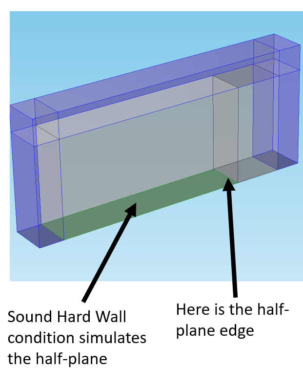

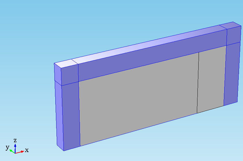

I am simulating the scattering of acoustic waves by a half-plane. The domain consists of a rectangular box with the half-plane at the bottom. The box is surrounded by PMLs shown in purple in the image below. Periodic boundary conditions are used in the front and back faces and the background field is a plane wave in the x-direction. I am using the pressure acoustics, frequency domain module and I would like to add a background mean flow in the x-direction.
