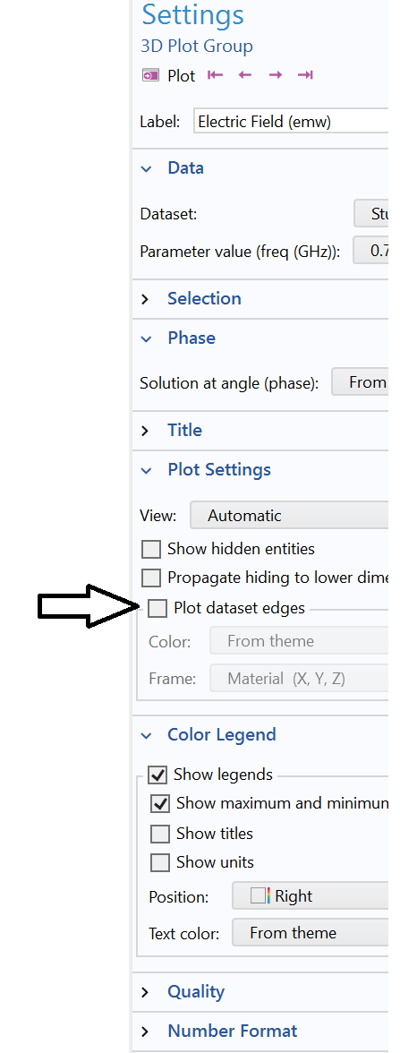

To hide edges in post-processing, consider unchecking the "Plot dataset edges" checkbox under Plot Settings in the Settings panel associated with your plot. For example, see the snapshot attached.
